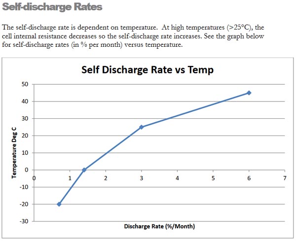

At 02:07 PM 6/16/2020, you wrote:
I let my fully charged EarthX sit for 12 months thinking it would be fine.
It was not. It was completely discharged and would not take a re-charge.
Hmmm . . . according to EarthX literature, expected
self discharge rates are pretty much in line with
other LiFePo4 products.
What conditions was it stored in? Did you have
any conversation about it with EarthX?

I believe their bms always protected from over discharge
but it could not protect against self discharge. For example,
a battery that has been 'protected' due to very low state
of charge still needs to be recharged asap. Just because
it has protected itself from external discharge, it cannot
stand of effects of internal discharge. This MIGHT be what
happened to yours.

Here is a guess at the charging, or lack of, problem.. from a guy that has never used the Xearth  battery.
Most Li based chargers, controllers, BMS, etc. have top and bottom voltage state sensors.
Translating this.... if the battery voltage for any reason has fallen below the minimum value, the charge controller will essentially block any attempt to charge the battery as it believes the battery is unsafe to charge.
The typical method to overcome this charging blockage is to trick the controller or bypass it for a very brief period of time.  And, using a conventional charger attached to the battery in such a way, usually the battery posts, as to put a brief charge into the battery.  Enough of a charge to get the cells voltage to rise above a minimum level.  Once that is done, usually connecting the battery to the Li charger, it will sense that the battery is sufficiently at a safe state and begin normal charging...
