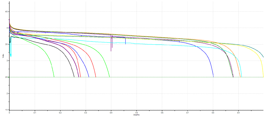

I observe that virtually all the COTS lithium
chargers in my stable, every one 'tops off'
at 4.2 volts. These chargers were used to
explore qualities of a bevy of 18650
cells laying around the shop. I've
attached a plot for a constellation
of cells. A plot of the as-found condition
of a cell was followed by a plot of a
recharged condition.
Most of the 'weak' cells showed marked
recovery . . . others did not. One interesting
feature of this exercise is to note the
starting voltage for the discharge plot
of each recharged cell.
Virtually all produced first delivery of
energy at 4.0 volts or more. Hmmm . . .
It seems this was related to charging
top-off voltage. Okay, if one wishes
to maximize exploitation of your ship'
lithium battery, do you want to raise
your alternator voltage to 4 x 4.2 =
16.8 volts?

  Speaking of LiFePo4:
  16.8 volts?
  Hmmm . . . most of our electro whizzies
  probably wouldn't mind . . . but if you're
  carrying incandescent lights of any size,
  service life would be reduced by 50% or more . . .
  but they would certainly be bright!
  I've posted an article found on powerstream.com
  See:  https://tinyurl.com/yazw9jnh
  By the way, check out the rest of this website.
  It's a treasure trove of data on DC power
  systems. I had the name of the author at
  one time but let it get lost. If anyone
  perusing this resource runs across the author's
  name, I'd appreciate a heads-up.
  The article illustrates some interesting numbers
  on LiFePo4 performance. First, there is
  little value in charging the LiFePo4 cell
  at it rated maximum. The writer demonstrates
  that charging at considerably lower levels
  does not significantly affect stored energy
  until charge-per-cell voltage drops below
  3.40.  Okay, 3.40 x 4 is 13.6 volts. I
  think we can live with that!
  In fact, we're told that the charge-discharge
  service life of lithium cells is improved
  by operating the cells between 30 and 90%
  of the chemical capacity of the cell. Okay
  operating the contemporary 4-cell array
  products at the legacy 14.2 to 14.4 volts
  (3.6 volts per cell) wont give up significant
  performance while extending service life.
  I'm going to repeat the experiment in the
  article cited. I will add features
  that explore system integration questions
  going to what may prove to be the 'next
  generation' of OBAM aviation electrical system
  architectures.
