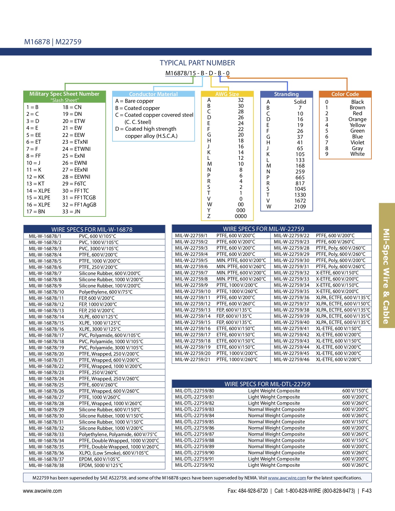

Here’s a chart of Mil-W-16878.
http://www.standard-wire.com/mil_w_16878_cable_designation.html
Not exactly sure what version you have but generally we want to use PTFE or FEP-coated wire, 600V, 200°C. For example the seller below handles mil-w-16878/4 which is nearly the same as mil-w-22759 commonly sold as aviation wire. One advantage is the -16878 comes in different colors. It sounds like your 200°C wire is a PTFE or FEP coated wire and would be good anywhere you would use -22759.

I have a collection of single conductor and shielded wire that
is all mil-w-16878D. Some is labeled as 200C and some with 105C
temperature rating. None of the wire is below a strand configuration
of 7/30.
You can see a table of characteristics for
the various forms of 16878 wire at
https://tinyurl.com/ydgex35d
Your 200C wire is Teflon (ETFE) insulated.
Not a 'bad' insulation but the stuff does
creep under constant pressure unlike the
preferred Tefzel (FEP). Just snug up
wire-ties and clamps . . . don't strangle
'em.

The question is, “should I use this wire? Also, if used,
should I restrict its use to the pilot side of the firewall?
The 200C wire is fine everywhere but yeah,
the 105C wire is best kept aft of the
firewall.
