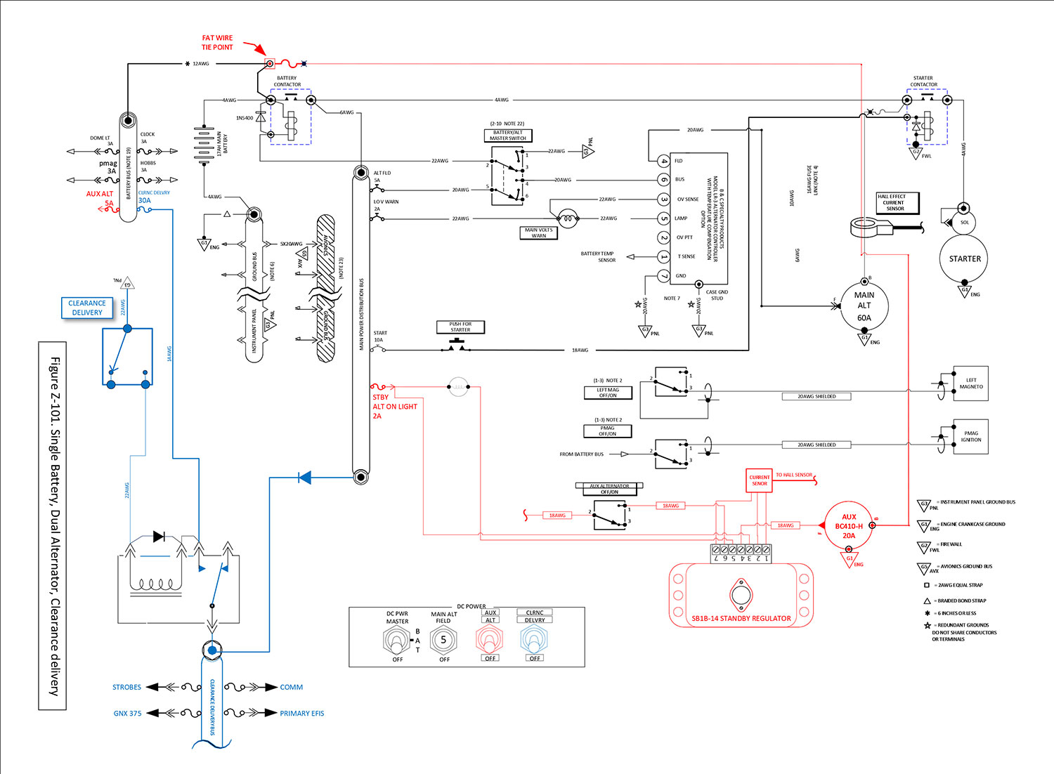

After looking over Z101, this is my first try at an architecture that would fit my mission.
Criticism will be taken as constructive, no offense taken.
Looking into my avionics suite, the Garmin GAD 27 controller should prevent brown outs so I eliminated the BO option.
The idea of having a clearance delivery bus to upload flight plans and well, get a clearance, really appealed to me so it's included. The strobes are on that bus so I would not walk away from the aircraft with the clearance delivery bus still energized.
Speaking to B&C today about their standby alternator had me include their standby regulator. The wiring of it is per their drawings. B&C say’s the standby alternator wired this way would run in parallel with the main alternator and would be excited and pick up the load when the main bus voltage fell below a predefined level and would need no pilot input. I’m not sure why they show a switch but I included it.
My plans are to have one Pmag or a SureFly mag replacement and a traditional mag, so that setup is included.
I’m sure I missed something and am looking forward to learning even more than I already have.
Yup, that's what it was designed to do. If $cash$ is
no object, the system will certainly perform as
advertised. I designed it.
I suggest that all that automation has no direct
benefit with respect to 'saving the day' in the
event of main alternator failure. The majority
of such systems will never be called upon to
perform their intended task. Well maintained
alternator up front is going to run TBO on
the engine. The Z101 philosophy was, "yeah,
I want that capability there and available with
just the flip of a switch for the least
cost of installation." But it's your choice.
What's your proposed fuel delivery system?
If your engine isn't electrically dependent
and you want the aux alternator will full
compliment of bells/whistles, then Z12
is your best fit.

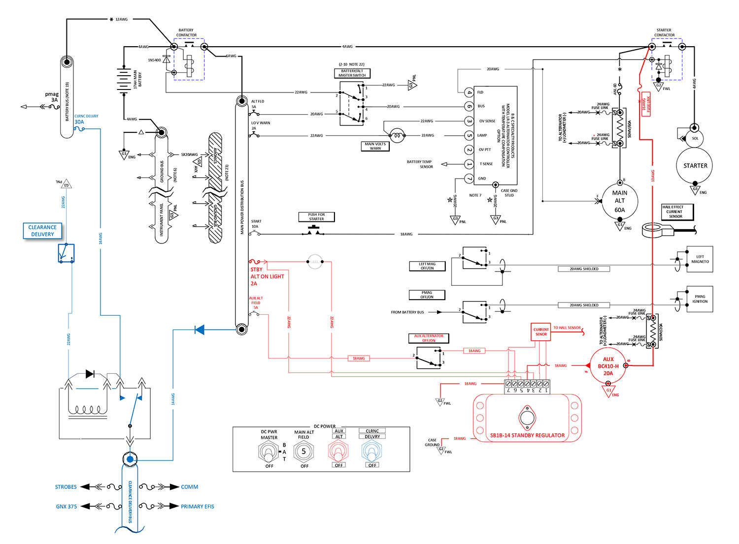

So I took your advice and crafted a Z-12 version.
Can some light be shed on the use of shunts as well as a Hall effect sensor?
I would like to have the information to my EFIS from each alternator. Do I have this drawn correctly?
Also, I was questioned on VAF about the Instrument panel ground bus and Avionics ground bus being tied together with the five 2AWG wires. It was also suggested they could be the same bus. I didn't have a ready answer.
EDIT: My fuel delivery will be a standard booster pump and fuel injection.

It may be my brain that is missing the connection, but I don't see the electrical path that feeds bus power to the LR3. The pole called upon to switch bus power goes nowhere.
Shouldn't the arc path of pole 5 be connected to terminal 4, replicating pole 2 and terminals 1 & 3?
okay. dump the shunts. run BOTH b-leads trough
the one hall effect sensor.
don't need both
the 'panel' ground bus is normally on the cabin
side of the firewall. I think I'm going to
change the name to 'cabin ground bus'. The avionics
ground is on the panel, centrally located to electro-
whizzies that reside on the panel.
Don't need a fuse block for the 'battery bus'. Put
the clearance delivery relay right close to the
battery contactor. Use a 3a inline fuse to feed
the pmag.

jonlaury wrote:
... I don't see the electrical path that feeds bus power to the LR3. The pole called upon to switch bus power goes nowhere...
That's a progressive three-position switch, off, battery contactor on, battery contactor and main alternator on.
Ref the paragraph heading "Switches" in Chapter 1, and notes 15 and 22 in Appendix Z of Aeroelectric Connection book.

I've incorporated some of your input along with
musings from the List and my own starry-eyed
stare down the highway.
https://tinyurl.com/y9n57vlw
This drawing needs some notes to explain
on some new ideas:
Z12 lite could be pretty simple. No optional
busses. Dual alternator dependability combined
with a dutifully maintained battery would
take you far and in confidence. This drawing
illustrates and preserves the aux alternator
installation as offered by B&C.
Depending on proposed accessories and operating
modes one might wish to add battery or
clearance delivery/endurance busses. Purely
optional . . . if you gotta use for one,
add it.
Question: your drawing shows a fused feeder off
the battery to the p-mag. What is the rational
for utilizing this source as opposed to simply
tying it to the main bus? What is the
current draw of this feature on the p-mag?

from Z-12. I was thinking if things really went bad with the contacter
open and a mag dead the Pmag would still be operating.
We're talking about a P-Mag, not an E-Mag . . . right?
P-mags have built in alternators. As I recall, the battery
assist was to support cranking and hand-propping
the airplane.
Haven't talked with those guys in a long time. I'll
call down there tomorrow and get my knowledge nugget
updated.
