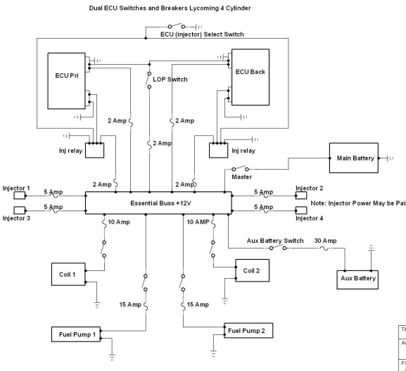

I am working with the folks at SDS on a scheme for providing a passive power path to the injectors with each bank being fed independently and alternate paths (using a more complex arrangement) to switch all injectors to one bus or the other if needed due to the loss of one bus or the other.
Poked around on the SDS website for a few minutes and
found this:
Disadvantages of SDS vs. Conventional
Aircraft Engine Systems
The big disadvantage of EFI compared to a carb or mechanical
injection and magnetos is that electrical power is required for
the pump, computer, ignition and injectors. The likelihood of
both the alternator and battery failing simultaneously is
practically zero with standard aircraft maintenance procedures.
Generally, a good battery will allow you to keep essentials powered
for 20-90 minutes after an alternator failure permitting diversion
to another airport. We consider proper gauges and/or warning
lights to indicate an alternator failure to be very important.
We have an ammeter, voltmeter, low voltage warning light and
buzzer now on our RV6A and also added a backup battery in Feb. 2005.
[img]cid:.0[/img][/i][/b]
I don't see anything that argues with the ideas
and architecture philosophies we've been discussing
here over the last week or so.
Their assertions as to component reliability combined
with the block diagram above illustrating everything
running from a 'reliable' bus confirms their
confidence in what's been recommended here on the
List in terms of insuring a supply of DC power.
I think the drawing above could
be 'cleaned up' a tad and may have an error
about the injector selector switch wiring . . .
but I think the spirit and intent of the
SDS is clear and raises no flags at this
time. It also confirms my suggestion that
running the entire SDS system from either
main or aux bus of Z-14 or the main bus
of Z-12 offers a level of redundancy
I think I could sell onto a TC aircraft.
I'm getting ready to hit the asphalt on a trip
to visit family in Cincinatti so I'll be off-line
until Sunday.

To (possibly over-) emphasize, quoting from above:
The injector control scheme, and the fact that the injectors are not redundant (two injectors per cylinder) seems to be what is creating the heartburn. I think I've been saying something similar; all engine stuff on one bus, with controllable redundant sources of power. It is, after all, what SDS recommends.
Charlie

PostPosted: Tue Feb 04, 2020 3:04 pm    Post subject: Z-14 for electrically dependent engine Reply with quote
Agreed. No 'enhancements' are recommended
or useful.
adamb
Joined: 04 Feb 2020
Posts: 1
PostPosted: Tue Feb 04, 2020 4:57 pm    Post subject: Re: Z-14 for electrically dependent engine Reply with quote
or useful.
So suppose there's smoke in the cockpit, not sure where it's coming from. A trained response is to shut off the master (both masters in the case of Z14). If the SDS stuff is on either the main or Aux busses and the masters are switched off, the engine shuts off...
I'd rather the SDS components be on the battery busses to prevent this.
This is the primary reason for my plan to power the ECUs, Fuel pumps, and Coils from their respective battery busses (there are 2 of each so one is fed from main battery bus and the other from aux battery bus). And provide a diode OR'ed Injector bus from the battery busses to power the injectors.
Others have taken the approach of feeding all components off of a "Engine bus" redundantly powered from battery busses.
Maybe I'm missing something, but I'm very uncomfortable not being able to shut off the master switches and keep the engine running.
Adam
user9253
Joined: 28 Mar 2008
Posts: 1978
Location: Riley TWP Michigan
PostPosted: Tue Feb 04, 2020 6:42 pm    Post subject: Re: Z-14 for electrically dependent engine Reply with quote
I agree with you Adam. The pilot should be able to shut off all sources of
electrical power at the source. Putting relays (independent of the battery
contactor) between the batteries and engine bus accomplishes that. In case
of smoke in the cockpit, most pilots would shut off the master switch first,
expecting the engine to keep running. If the smoke gets bad enough, then
electrical power to the engine bus can be shut off along with the fuel valve.
Joe Gores
ceengland7(at)gmail.com
PostPosted: Tue Feb 04, 2020 6:42 pm    Post subject: Z-14 for electrically dependent engine Reply with quote
> or useful.
> Bob . . .
Adam
That's what I did, though my system is dual alt/single battery. Engine
(all of it) is on one switched 'hot' bus, that can also be fed from the
main a/c bus. Smoke emergency would be just like a traditional
installation; master off & the motor keeps turning.
Charlie
