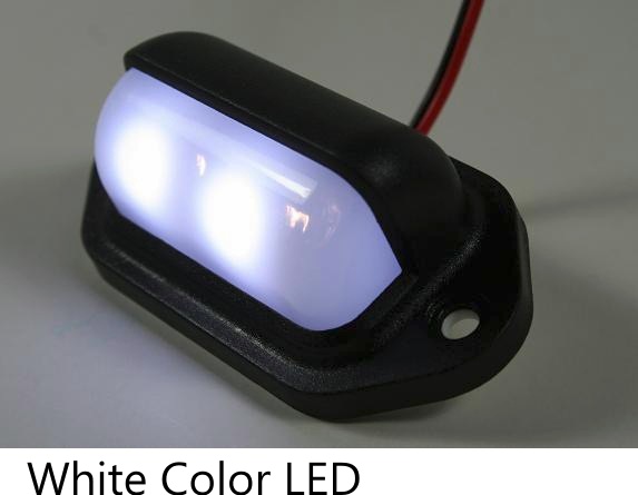

I have installed, in the baggage compartment of my RV-10, a couple of these LEDs lights
[img]cid:059D9AC1-DA22-4C18-9E75-99F731530A1D[/img]
I want that these lights are lit whenever the baggage door is open, like we have in our cars.
Therefore I connected the lights to the microswitch which already was used to indicate that the door is open, in one of the alarm features available in the Garmin G3X system.
This alarm feature requires that the microswitch used to indicate the open door is connected through a ground circuit, i.e, this microswitch is a N.O. one, and connects the circuit to ground whenever the baggage door is open.
So, these 2 LEDs lights are permanently connected to +, and get ground only when the microswitch is open, simultaneously when the door is open.
Now, when the baggage door is open, the lights are On, which is good.
The mystery (at least for me, as I am a bit electronics challenged) is that when the door is closed, these LEDs lights are dimmed lit...
This has an explanation, of course, but I don’t know it.
Why these LEDs lights emit some light, although down dimmed, when they have power in the red wire but no ground in the black wire?
I suppose that this dimmed light represents some battery power consumption, so, is there a solution for my problem? Any diode to be put in the ground wire?

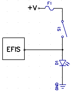

Do they light up with the door open if the EFIS isn't powered up? I'd bet they don't.
If they don't...
Consider that the EFIS must supply a a voltage to the microswitch (likely around 5V and very current-limited) in order to detect that the switch has closed. With the switch open (door closed), and the EFIS powered up, there's a potential difference between your 12V battery supply, and the <5V?>  source voltage from the EFIS.
Try removing the line to the EFIS temporarily and see if the light goes out completely when the door is closed.

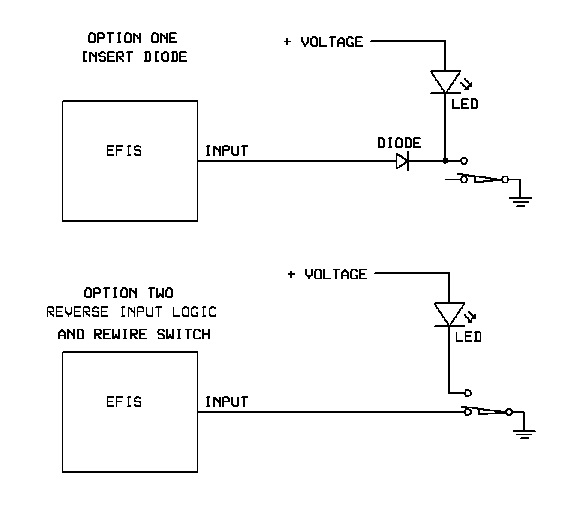

The attached pictures are my interpretation of Carlos' description of the circuit.
In the top circuit, I have inserted a diode as suggested by others.
That is the easiest solution. A 1N4148 should work.
The bottom circuit requires reversing the switch logic and EFIS input logic
which should be easier than purchasing a new switch and installing it.

 On 11/9/2019 1:09 PM, Carlos Trigo wrote:
 Dear electronics wizards
<11-09255m.jpg>

Joe, check your diagram again. In option two, it looks like you still changed the switch and forgot to swap the circuit polarity; it shows a SPDT, and it's still switching the EFIS input to ground.
Is this what you intended, using the existing switch?
[img]cid:a669a7cb-2692-9d91-c8ae-25d966131055(at)yahoo.com[/img]">
Cheers,
Eric
Joe Gores

Eric, I drew the circuit as I intended. I assumed that the existing switch is
SPDT and that the EFIS input is currently connected to the normally open
switch terminal that gets grounded when the door is open. I suggested that
the EFIS input wire be moved to the other switch terminal so that the EFIS
input is always grounded except when the door is open. That will require
going into the EFIS setup menu and changing the logic so that the alarm will
sound when the EFIS input is not grounded. If I made a mistake, let me
know. It is confusing when talking about a switch opening and closing, and
also talking about a door opening and closing, and they might not both be
open at the same time.
Joe Gores

I will try option One.
Although I am more inclined to use 2 separate circuits.
Carlos

OK Joe, I see my error now. I misinterpreted your sentence about changing the logic of the EFIS input. My brain read that as changing it from a switch-pulls-low to a switch-pulls-high condition, but you meant to invert the way the EFIS reacts to the existing switch-pulls-low input. Makes sense now.
I suppose my drawing could be a third option, if the EFIS can be configured to accept a high input to activate the door annunciation.
Anyway, lots of options. Sorry for muddying the water...

PostPosted: Sun Nov 10, 2019 2:00 pm    Post subject: LEDs light mystery Reply with quote
Led's will produce light at VERY tiny currents. I suspect
the current present in the door-closed state is the
tiny drain presented by the EFIS input circuit.
I have an LED lamp in the ceiling of a bathroom that
will not quite go out . . . the wiring between the
controlling switch and the lamp fixture is a bundle
of multiple circuits. I'm pretty sure that I'm seeing
some CAPACITIVE coupling to the floating lead that
carries normal ON-voltage to the fixture. It's tiny
to be sure but leds aren't picky. The room has to be
totally dark to witness the effect but it's there.
In your case, you could put a multimeter in series
with the supply lead to the fixture. I suspect it's
very low and may not represent a serious performance
issue for the battery. Some cars have tiny parasitic
loads to keep things like door opening receivers
hot.
You can get rid of the dim light by simply adding
a load resistor across the fixture . . . low enough
resistance to drop voltage across the fixture to
less than 2 volts or so . . . the light will then
go out.
This will NOT make your parasitic current go away,
so you'll still need to investigate its significance
with respect to battery life.
If you want the easiest way to make it go away
then put the microswitch in the SUPPLY lead to
the baggage compartment light and then set
your efis input to active HI for DOOR
OPEN annunciation.
