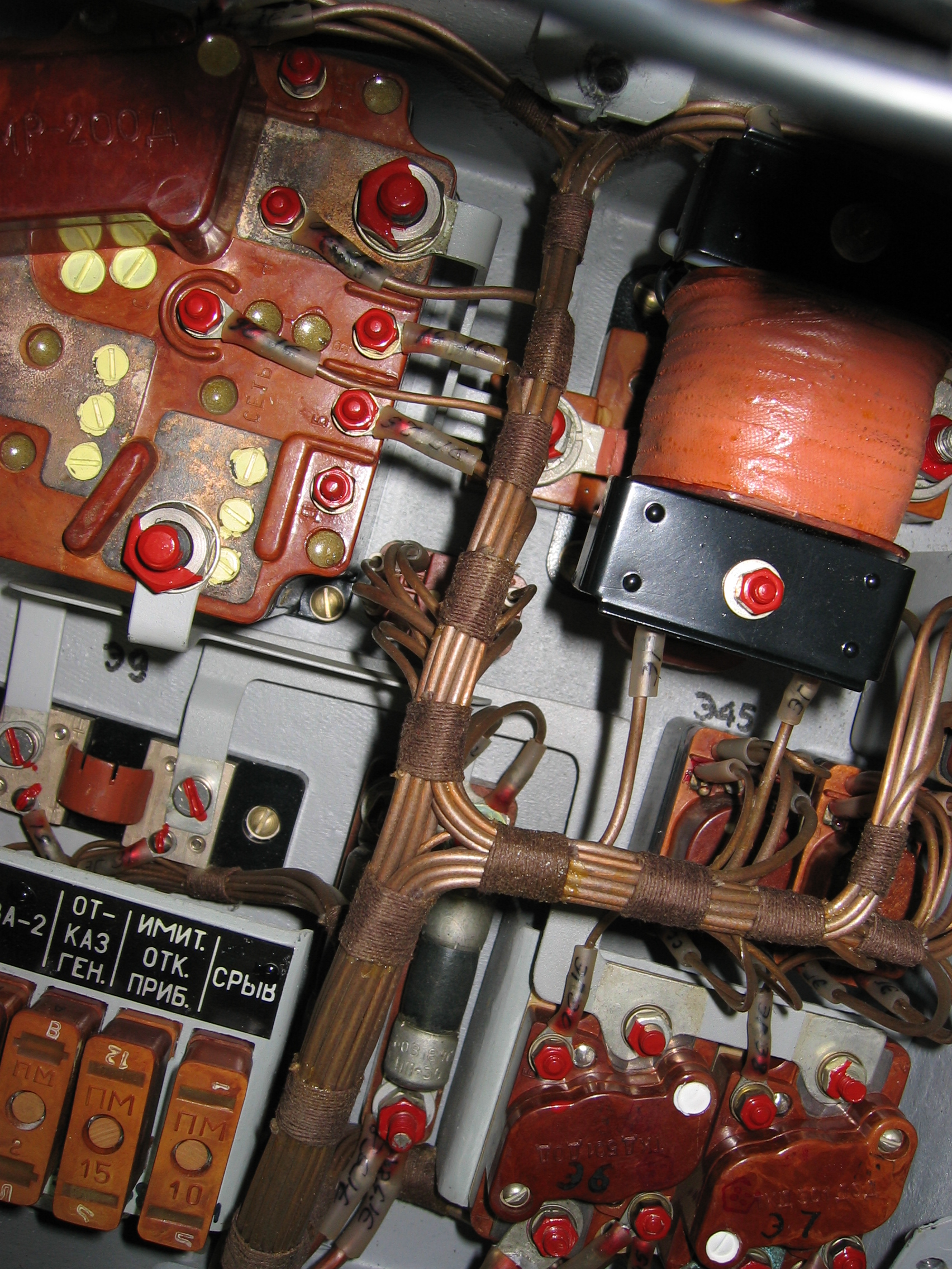

Walt, in the YAK-50 and 52, there are two Master Power relays. One for
ground power and one for battery power. I am not sure what model Yak that
Bryan has, so I will go on the assumption it is not a 55. Both of these
relays are located in the main electrical panel which I assume Bryan knows
about. If not, on the 52 it is located on the right side, forward of the
cockpit, remove access panel and look for blue box with a cover held on by
two knurled knobs. On the 50, it is located in the hell hole on the
firewall. Same box.
I have a picture of this box, and the relays in question and am sending it,
but don't know if it will post to the list server. Bryan and Walt, I am
sending it to you both personally. On the bottom right are two relays
arranged vertically. . These are your ground and battery master relays.
These two relays are identical and in an emergency, the battery relay can
with switched with the ground power relay restoring operation until you can
get a new one.
All that said, you might get lucky. In the middle of the picture, located
underneath a metal bus bar strip is a big black bus fuse. This fuse is on
the bottom middle, just to the right of the DMR-200 Combined Relay. If this
fuse blows, it will cause your exact problem. The fuse has terminal lugs
soldered to each end, and you can remove those and put on a new fuse you can
find at Lowes, or you can replace the fuse with a circuit breaker. This is
a very old style bus fuse and can fail simply by mechanical vibration, so it
is the first thing to check.
Good luck,
Mark

Mark - the picture you posted intrigues me as it's a very different layout to my 1991 YAK-52 DC relay box (see image), where the 50A bus fuse is located in the port wing battery compartment. Note #6 relay is second one in from bottom right. Is your picture of a -50 box perhaps with an integral 20A fuse? Just asking :-)

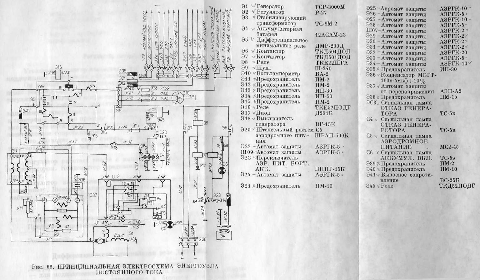

Once my 52 had same symptom. As mentioned, it was "Э6" ТКД501Д0Д relay/kontactor. The "Э7" is the relay/kontactor for ground power.
I believe they can be swapped in a pinch.
