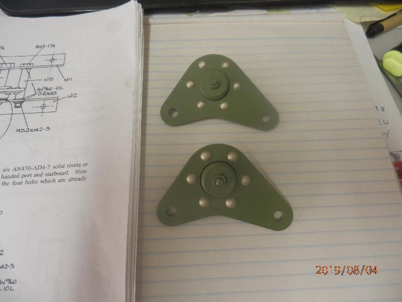

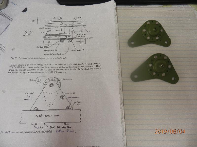

I'm in the middle of XS wing construction and have just riveted the
BC4W10 to a W13 Bellcrank. To save time I riveted a second one, exactly
the same. Now I am thinking they should have been a mirror image of each
other. Are there any builders with really good memories (or records) out
there that can confirm I have screwed up?
Brian in Aus.

Hi Brian, the aileron assemblies are ‘handed’ (mirrored), I don’t think you can get away with just flipping the bellcrank around either but you might try.

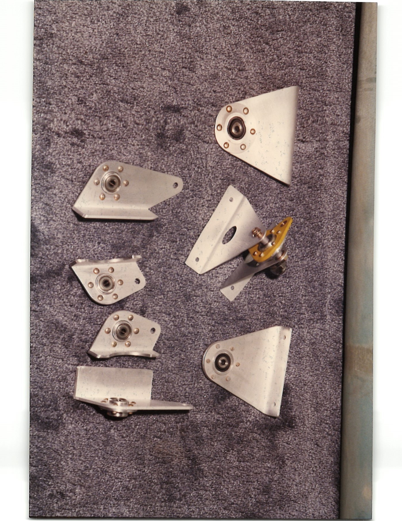

Brian,
Sorry, but they are mirror images. See picture.
Happy building!!!

Doh!  Thanks for the photo Bill. One step forward, two steps back.......
