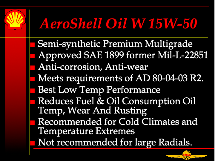

j.mevis(at)computer.org
PostPosted: Mon Jul 29, 2019 10:58 pm    Post subject: 25W-60 vs 20W-50 for the Housai? Reply with quote
Aeroshell does not recommend its W15W50 for radials.
I tried to upload the whole powerpoint but the matronics-list refuses doing that.
BR,
Jan
From: <owner-yak-list-server(at)matronics.com> on behalf of Royden Heays <heaysr(at)telus.net>

 Filesize:  132.9 KB
 Viewed:  20713 Time(s)

You can download the Aeroshell book on:
https://www.shell.com/business-customers/aviation/aeroshell/knowledge-centre/the-aeroshell-book/_jcr_content/par/textimage_1433441235.stream/1445039847869/64a1a7d0fdadb6377a29d795dc9583e7c30e12b3/theaeroshellbook.pdf#page=1&zoom=auto,581,149
It’s all well explained in this book.
BR,
Jan
BR,
Jan
