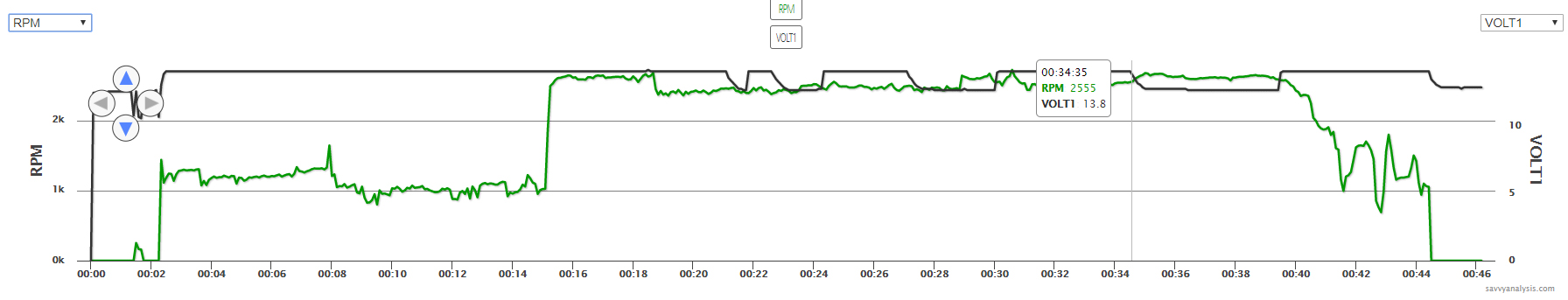

The alternator on our O-200 intermittently died on a flight today. In total it quit 4 times, the longest for almost 4 minutes. After landing we wiggled all the wires, checked several for continuity, everything looks good. We have no cooling air going to the alternator at the back of the engine and it was a warm day and the engine compartment was very hot.
Is it possible this is a heat problem or definitely wiring / regulator / alternator?

That 13.8 is at the start of a failure cycle. Normal bus voltage has been 14.1 on the last several flights.
The engine was recently overhauled, I'm trying to find out if the alternator was as well. It looks new.

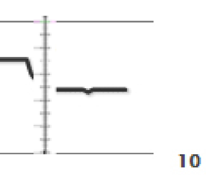

[img]cid:.0[/img]
I put a 'ruler' on a piece of your
data plot and it appears that alternator
OPERATING is on the order of 13.7v, alternator
OFF is 12.4v or battery only. you've got a
LOT of on/off transients.
Does this alternator have a built in
regulator or external regulator?
If INTERNAL regulator, the alternator
is defective. If EXTERNAL reguator,
you need to put a voltmeter on the
Field terminal during a flight to
see if the transient is upstream
(in the regulator or associate
wiring) or downstream (in the
alternator).

Operating is 14.1, not operating is about 12.7. Please see the link below which I should have sent to start with. I find it strange the way the voltage slowly drops rather than a sharp on/off drop. Maybe I'll try the switch to see what that looks like on the graph.
I will place a voltmeter on the field line next flight.
https://www.savvyanalysis.com/flight/3309601/fa4df24a-e512-4297-bf73-2a797c6ab36b
  Okay, it sounds like this alternator
  has no known track record.
[img]cid:16becc23da6d9a3031f1[/img]
  alternator).

I don't know if it is significant but it seemed to be offline for longer periods each time during the flight. Going by the download you linked to.

Yes I found that strange. Each cycle was longer both in duration and in time before the next one. Probably random though.
