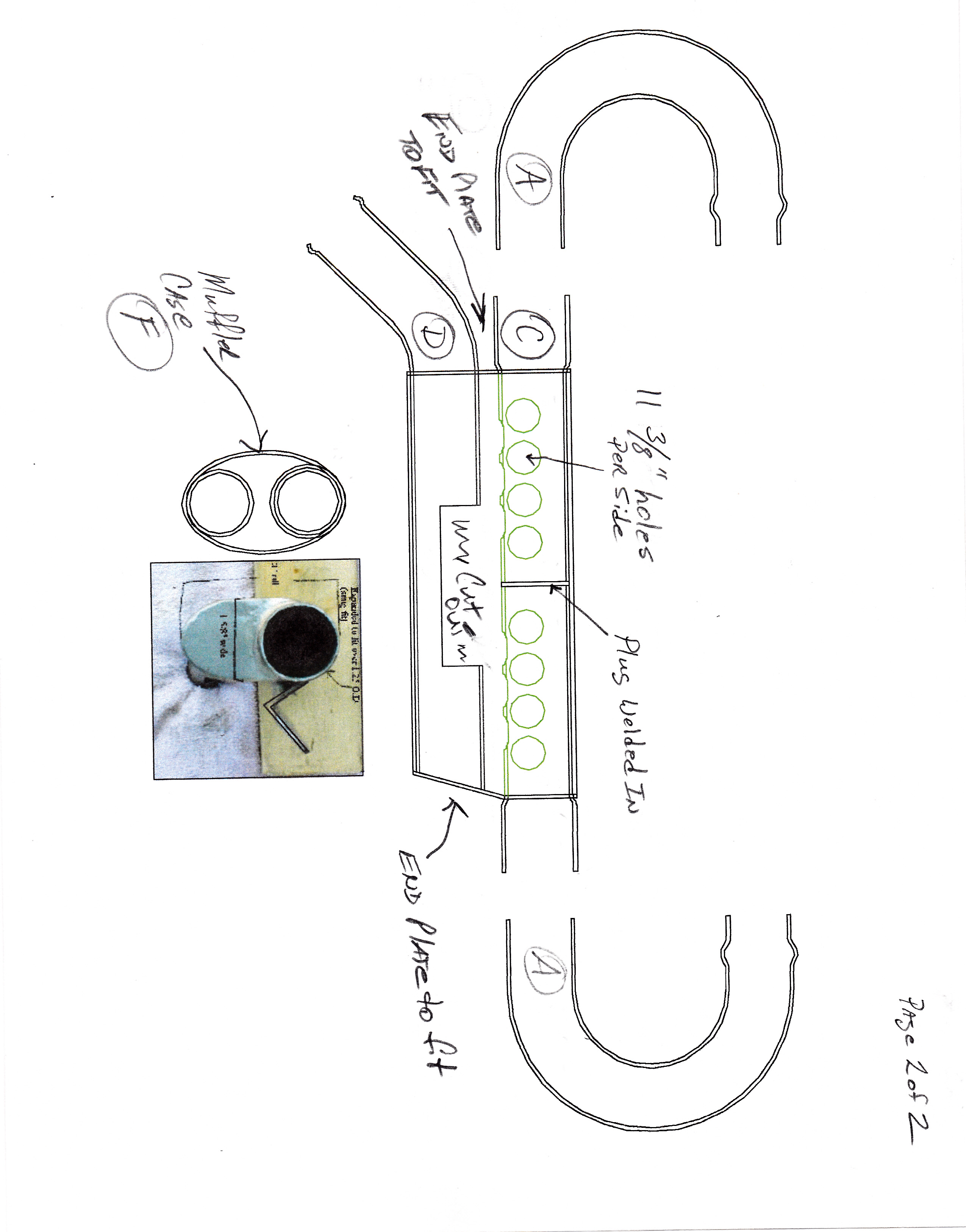

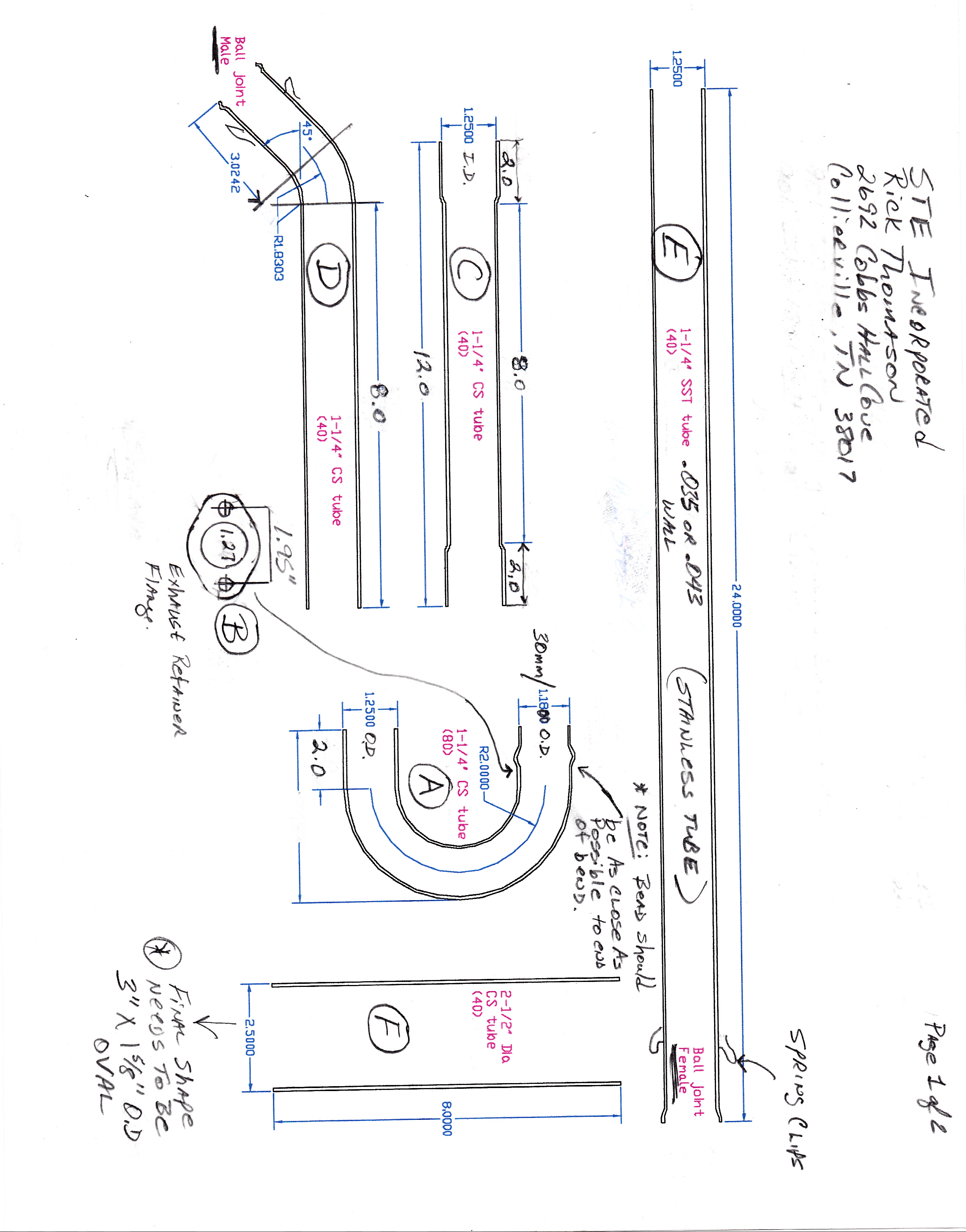

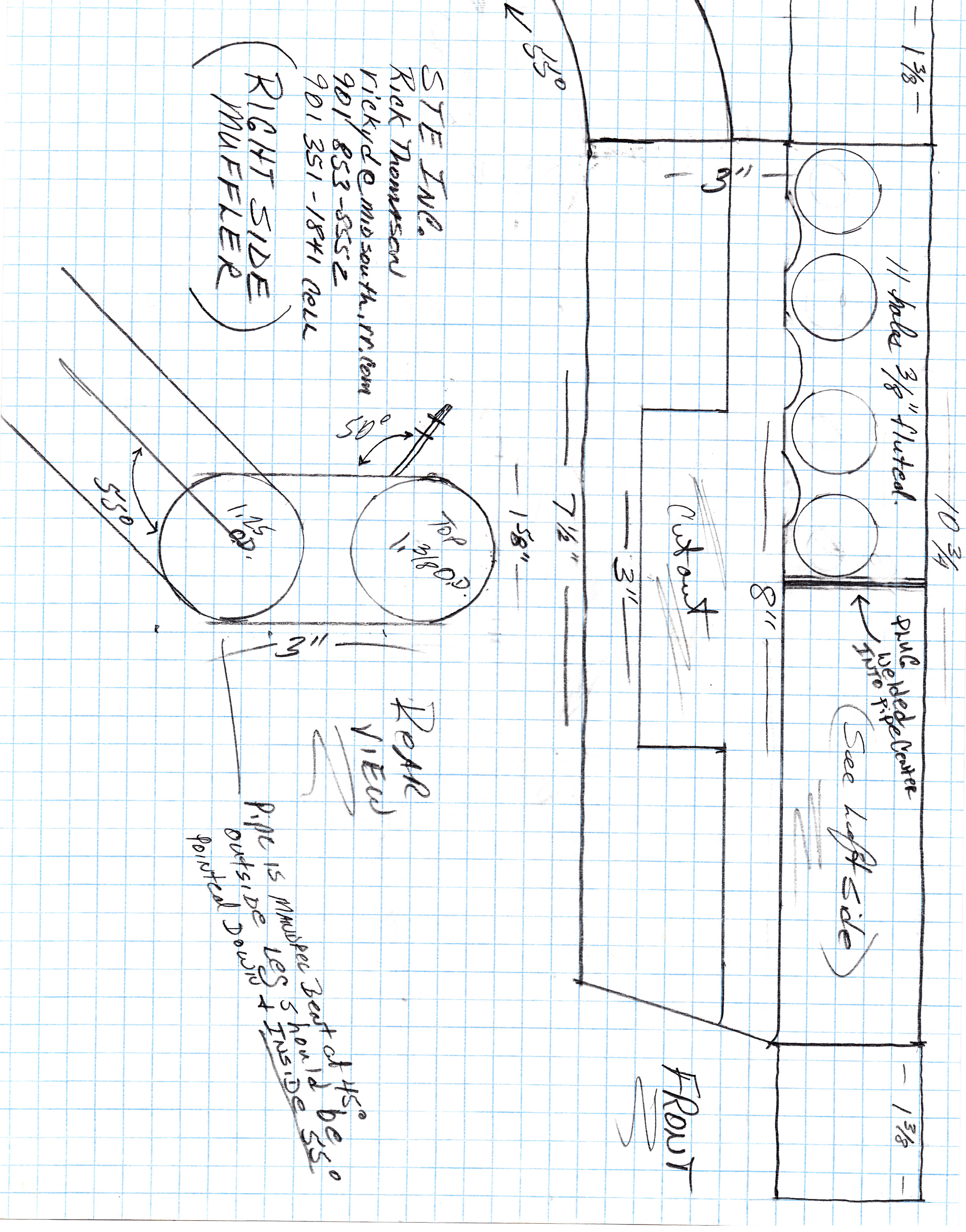

There is a Yahoo Pulsar Group with drawings of Rick Thomson’s exhaust. Here is the link to the first drawing but you may need to join the group to access it. I’m not sure.
Hope this helps,
Ned

Here is the group home page
https://groups.yahoo.com/neo/groups/Pulsar-Aviators/info
And here are the 3 photos of Thompson’s drawings
[img]cid:252B6553-7DE3-49DF-AAF2-7C9BD925693A[/img][img]cid:7787096E-A59B-4D68-8883-C2F5B68A8094[/img][img]cid:176A3E68-8F05-40F5-9AED-DE551C1D1932[/img]

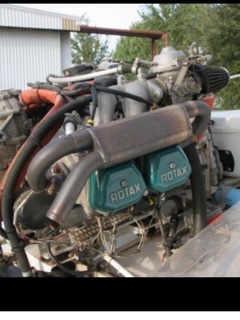

kenw
Joined: 01 Oct 2015
Posts: 25
Location: Oklahoma City
PostPosted: Fri Feb 12, 2021 2:48 pm    Post subject: Re: Original Mufflers Reply with quote
Do any members have pics of Rick Thomason mufflers .?
Thank you in advance.

PostPosted: Fri Feb 12, 2021 3:28 pm    Post subject: Original Mufflers Reply with quote
Knew,
There was an engineering drawing made and it is in the files, unfortunately I can not direct you to it but you should be able to find it.
Dennis

phil(at)ishml.com
PostPosted: Fri Feb 12, 2021 3:33 pm    Post subject: Original Mufflers Reply with quote
Drawings and pics are at the groups.io site...
https://groups.io/g/Pulsar-Aviators
Phil

PostPosted: Fri Feb 12, 2021 3:40 pm    Post subject: Re: Original Mufflers Reply with quote
Thank you Sir ! That’s helpful.
I was able to find 1 pic.

Look in the Photos section. The 2nd folder is "Exhaust", and I just put 3 JPEGs in there. They're sketches of Ricky Thomason's exhaust for the 912.
It made more sense to me to put them in the Files section, since they were more 'tech' than 'pretty'. But the system wouldn't allow 'photos' in the Files section, and told me to put them in the Photos section.
Tim Engel

I just did a little browse of the Files section on Groups.io, and found duplicates of the three sketches that I just uploaded in the Photos section.
Photos:
https://groups.io/g/Pulsar-Aviators/album?id=260646
Or, go to 'Files. Then scroll down & open the "Modification - Airframe & Engine" folder, and finally, open the "Exhaust - 912 XP by Ricky Thomason" folder.
Files:
https://groups.io/g/Pulsar-Aviators/files/Modification%20-%20Airframe%20&%20Engine
They're large files, burning up storage space. So rather than leaving duplicates, I'll delete mine from the 'Photos' section in a few days... after Ken has had a chance to find & download what he needs.
Tim Engel
