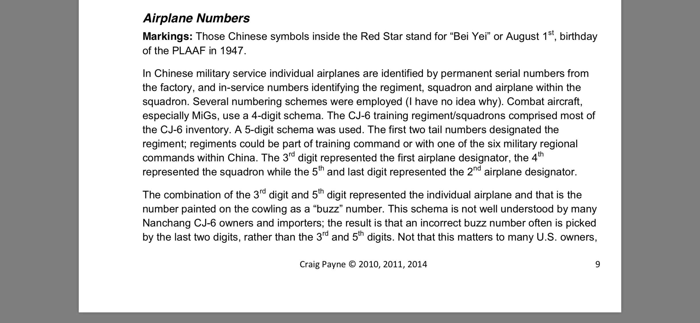

I have heard of two ways to buzz number the aircraft. One way is the last two numbers of your serial number. The other way is the third from the last and the last number of your serial number.
The second way of doing it is explained here in the attachments. Which one is correct?
What would you use for this number? 2532051
51 or 01?

PostPosted: Mon Oct 22, 2018 4:08 am    Post subject: Re: Buzz Numbering Reply with quote
There’s a number of reasons I tend to believe that Craig Payne’s version is correct. First of all, supposedly the aircraft was given only 40 gallons of fuel to eliminate pilots from defecting and flying off with the aircraft. Secondly, the communist country has always tracted and followed every little movement that their people do. So I could see how they would want to know exactly where that aircraft was supposed to be by just looking at the serial number. He also gives a very detailed explanation for every number listed under the serial number.
I’m just trying to get some additional information on the topic.
So Richard, would you say that given that serial number listed above that the buzz number would be 01?

PostPosted: Mon Oct 22, 2018 10:28 am    Post subject: Buzz Numbering Reply with quote
CJ6 Numbers etc;
As for the A/C Serial no. it is simple and straightforward:--------
Eg: My CJ 1532013-------- 15 is the Batch number which would identify
the time frame (and the Engineering status) in which this group was
produced. 320 identifies the producing factory. In later production a
second factory was added and identified as #512 (if memory serves correctly)
and finally 13 identifies the 13th airframe produced in Batch # 15.
Being far too old and stupid to know what a "buzz" number is I will describe
instead the squadron identification number. This number is abbreviated to 2
digits
and shown on the cowling and vertical stab. for quick ground ident.
Two of the four CJ's I imported were from the same squadron and showed
ident. numbers on all log books and other documentation as #935 and #936.
The numbers on the A/C were (and are still) #35 and #36.
Walt
