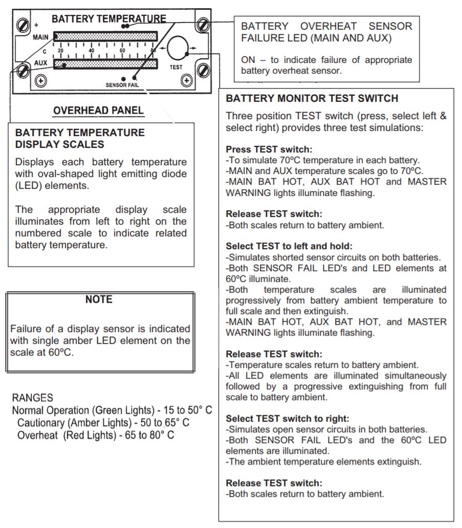

This raises a recollection of experiences
with another shotgun wedding between
poorly matched components. Waayyy
back when we got all exercised about
what was then a big quantum leap
in light weight, robust cranking
batteries with flooded NiCads.
After setting a few airplanes on fire
with a marriage of nicad and twin
turbines, powers-that=be decided
that the BEST thing to do was add
a remote reading battery temperature
meter paired with yellow warning
and red danger lights designed
to assist crews in managing their
'orchids' to prevent overheat
and thermal runaway.
I argued then that we could craft
an accessory to the starter-generator
controllers that would automatically
adjust bus voltage in response to
battery overheat. That wasn't well
received so we added another thing
on the panel that was harder to
install and drove up pilot work
loads.

After setting a few airplanes on fire with a marriage of nicad and twin turbines, powers-that=be decided that the BEST thing to do was add a remote reading battery temperature meter paired with yellow warning and red danger lights designed to assist crews in managing their 'orchids' to prevent overheat and thermal runaway.
Indeed, the deHavilland DHC-8-202 that I flew in a previous life was fitted with battery temperature gauges on the overhead panel (just below the left fire t-handle in the linked image).
https://bitly.com/2uj9V9F+
The airline I worked for operated them in the desert southwest, where ambient temps routinely exceed 100°F. Given the short-hop, quick-turn nature of the flying we did, and the eye-watering current required to start a >2,000shp engine, we kept a close eye on those gauges.

So the agile BMS watches temperatures
and strives to limit those effects
on the cells irrespective of system
demands from the outside.

Did you ever have occasion to take
a hot battery off line?

Did you ever have occasion to take a hot battery off line?
Just once, but not in flight. After flying three Phoenix-Yuma-Phoenix round trips on an especially brutal July day, we exceeded limits and couldn’t start up for the fourth scheduled Yuma turn. I can’t say that either of us was particularly bothered by the forced break!
An aircraft of that size and vintage may have had a battery charger that
monitored temperature and could limit charging current??
It seems like the Lithium "BMS" strategies are moving in that direction.
Limiting the alternator size as per Earth-X recommendations is a small
step in that direction which I applaud.  Even with VRLA batteries I
tossed my 100+ amp alternator in favor of a 40 amp unit.
Ken

An aircraft of that size and vintage may have had a battery charger that monitored temperature and could limit charging current??
Don’t quote me on this (it’s been awhile...) but as I recall, the temperature monitoring was separate from the charger. I think the charger’s only “data inputs� were weight-on-wheels and where its AC Power was coming from (external or engine-driven generator).
Eric
Don't think so. The 'charger' was not much
different than what we have in our airplanes:
An engine driven power source regulated to
idealized charging levels for the battery.
Some airplanes had two engine driven sources
like starter generators. These would parallel
for delivering up to 800A. The larger
aircraft would also have a auxiliary power
unit good for perhaps 200-300 amps that could
be operated in parallel with ships generators.
None of the generator controls were fitted with
any way to monitor either battery temperature or
current.

Don't quote me on this (it's been awhile...) but as I recall, the temperature monitoring was separate from the charger. I think the charger's only data inputs� were weight-on-wheels and where its AC Power was coming from (external or engine-driven generator).
If the aircraft had 3-phase alternators
and separate starters, then DC power was
derived from transformer/rectifiers to
run DC systems and recharge batteries.
These aircraft were generally large enough
to carry an APU which was used to start
engines thus reducing demands on the battery.
These systems could easily include features
for battery management.
But for twin-jets up through ships like
the Hawker 800 series, batteries were
connected to a bus powered by generators
with a LOT of output capability. Any
necessary monitoring of battery temperatures
was a simple thermometer gage with warning
and danger lights.
It was up to crew to notice and then
take an overheated battery off line until
it cooled.
