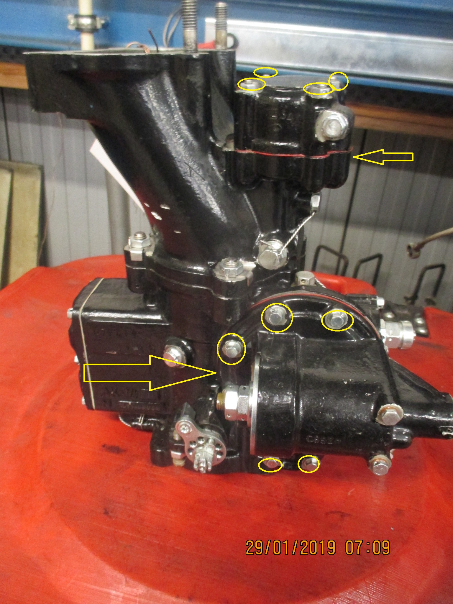

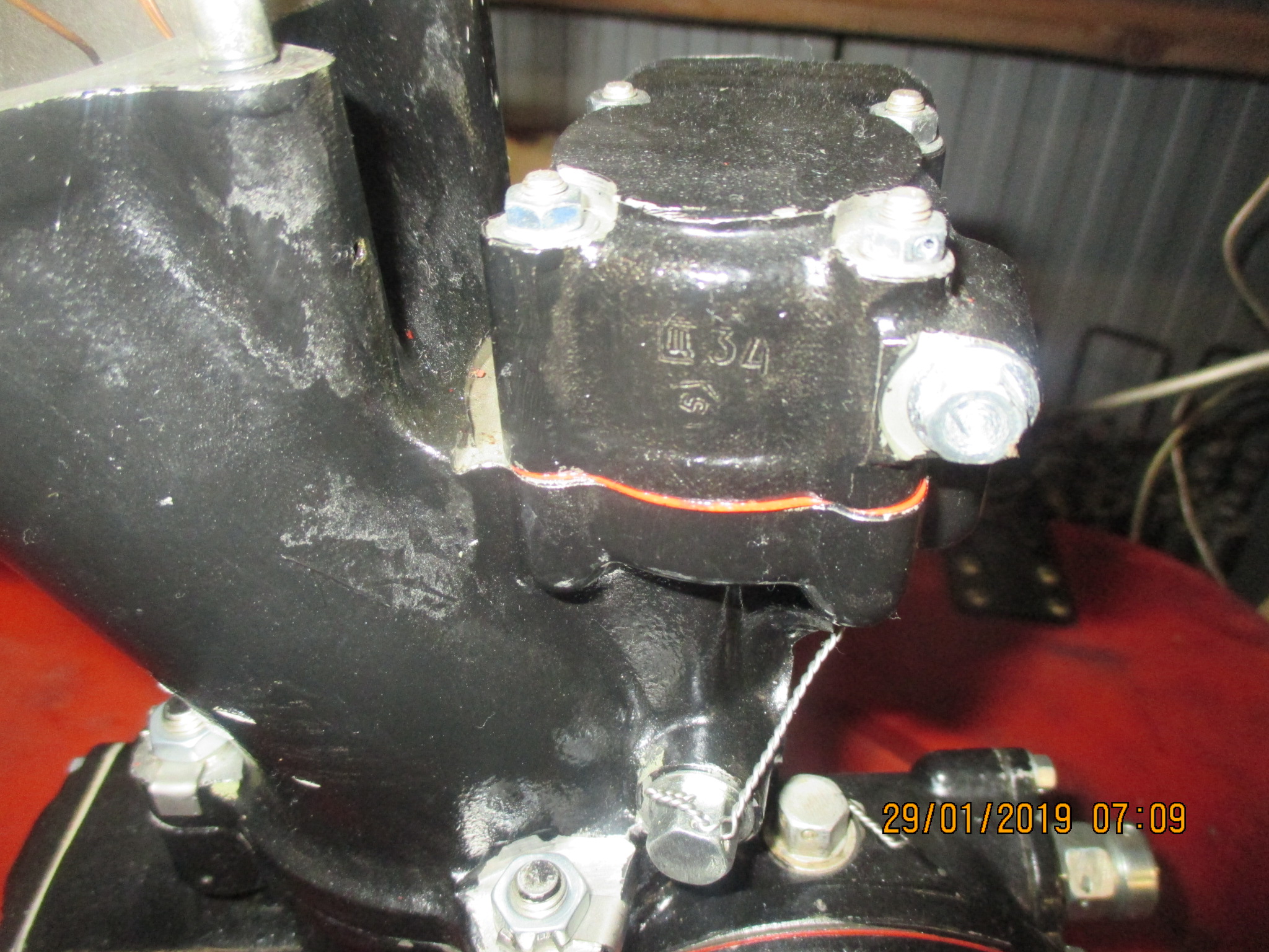

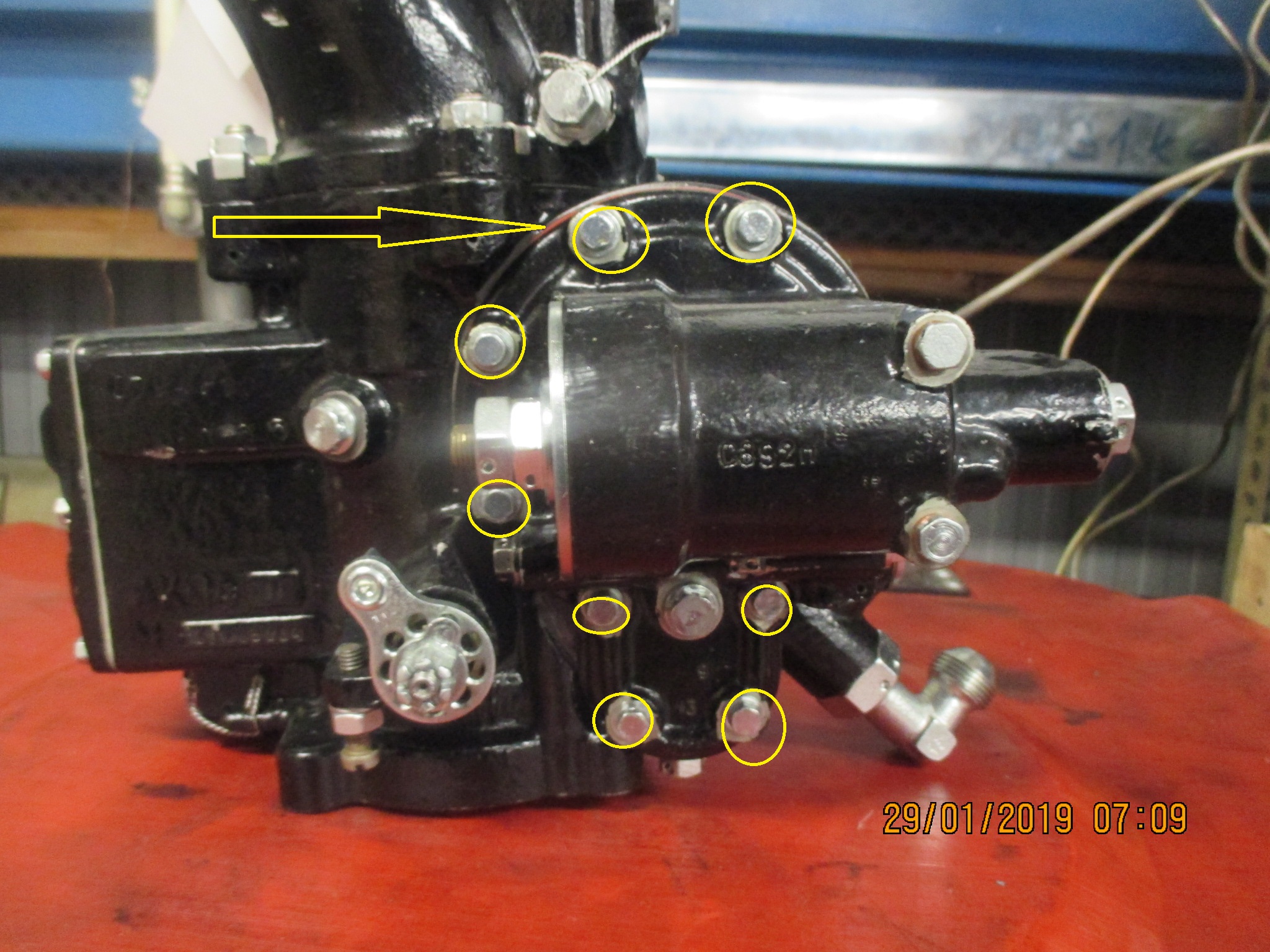

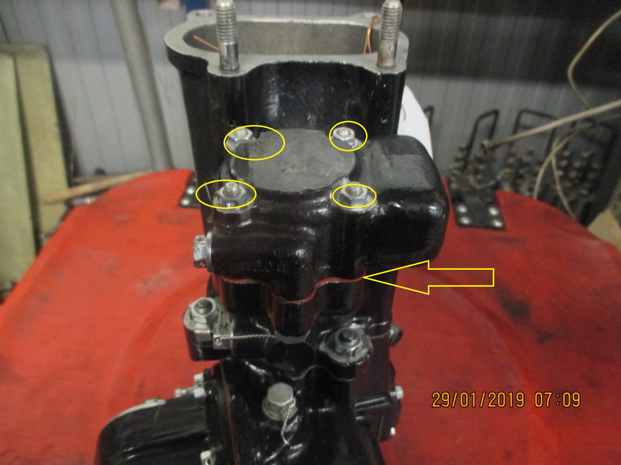

Apologies – I had said that I would send this before but got distracted! But from our partner, Aerometal in Hungary, this is the location of the two membranes in the AK – 14 carburettor as fitted to the M 14 P and PF engines.

From: Márczy Marcell [mailto:marcell.marczy(at)aerometal.hu (marcell.marczy(at)aerometal.hu)]
Sent: Tuesday, January 29, 2019 6:32 AM
To: 'Richard Goode' <richard.goode(at)russianaeros.com (richard.goode(at)russianaeros.com)>
Subject: RE: FW: location of carburettor membranes
Dear Richard,
For the carburettor, please find attached the photos. I marked the plates that should be take off. This one is an overhauled carburettor, so you can see the red membranes where they are exactly.
There are some bolts that are invisible, but I think now it is clear.
