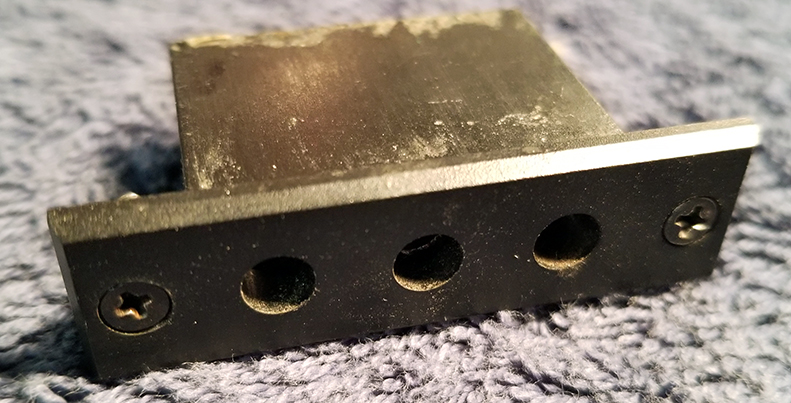

Hello,
A fellow homebuilder friend of mine has a old-style three-LED (Red|Green|Red) MAC Trim Position Indicator. The Green LED was burned out, and the wires were cut off too short.
I told him I would try to replace the LED and lead wires. I got it apart without completely destroying it. But the internal wiring and polarity of the LEDs isn't that clear to me, nor is the actuation of it through a servo electronically. I'm not sure how to activate three LEDs with only three wires? (Or did there used to be four wires?)
Does anyone have a PDF schematic of the 3-LED MAC Trim Indicator that you could email to me?
Or better yet, does anyone have a spare or unused one of these they would like to sell me?

Is it accessible enough to clip-lead the LED in for testing? If so, just pick a direction. If it works, you're done. If it doesn't, reverse the leads. Assuming that the current limiting is done external to the LED itself, it won't matter if you insert it backward; it just won't light up.

Matt, why not supply us with a close up photo or two? Often, the LED polarity can be identified by a difference in the legs of the LED. If the leads are to short to extend, could you de-solder them [one at a time] from the board and solder in new leads?
