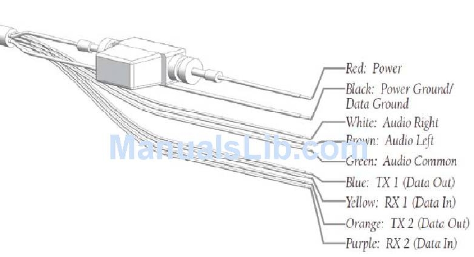

Appendix D of the users manual describes
this item:
[img]cid:.0[/img]
A 'bare' wire interface between the Aera660 and
ship's systems. Also, the manual speaks to an
internal, 3A fuse in the cigar-lighter plug.
This is a common connector to many automotive
add-ons. The fuse installation takes up a substantial
volume of the connector shell . . . it seems
very unlikely that it contains additional
electronics . . . a disassembly would confirm.

I've managed to get hold of a Garmin GPS lead, and the plug that goes into the unit has four pins, two are dormant, the other two are 12v + & -, the cigar plug once dismantled has indeed a glass fuse link, so all good for 12v fused to the aircraft bus.
