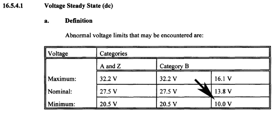

Even an AGM battery will charge (perhaps slowly) at any
voltage over 13 volts. Almost all 14 V aircraft electrowhizzies
will operate fine on 13V.
They DO160 qualify down to 10.0 volts
