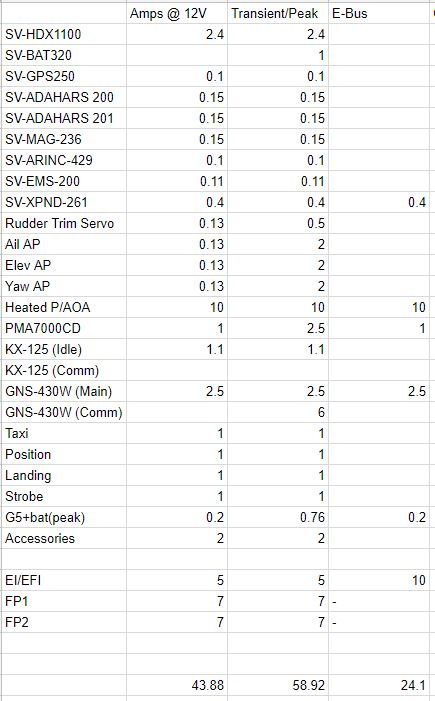

Primarily because the BC410-H standby alternator won't provide the 43.88 amps I need for IFR cruise for everything on the main bus. It seems reasonable to put the power generator on the e-bus for my electrically dependent engine as it's an easy way to isolate those critical components.

That sounds like a fairly high continuous load. If I am in conditions to
need pitot heat, all my avionics, nav lights, strobes and pitot heat
totals about 23-24 amps. Adding landing light, which is not considered a
continuous load only gets me up to 34 amps. That is with certified IFR
GPS/nav/com, second nav com, ADS-B in and out equipment, two 10"
EFIS/MFD screens, 2 axis autopilot, LED nav/strobe lights, 2
incandescent landing lights. My load total includes a couple amps for
charging the EFIS backup batteries. Old incandescent nav lights and tube
type strobes instead of LEDs wouldn't get me to 40 amps.
IF you are into a standby alternator, the second nav/com can be turned
off. The second EFIS screen could be turned off. Etc. A standby should
not have to carry more than your essential load, not a full night-time
IFR deice type of load.

I'm not Dave, but one possible reason for the difference could be an
electronic injection engine. The fuel pump alone will be around 6A.
Another amp or two for ignition, and the injectors can peak at several
amps each. Those are likely minimum numbers.

I agree it is a high continuous load, nevertheless that's what's required. Albeit with a little headroom on some things (lights, for example).
ETA: EFI is more like 16A max for all cases, so these numbers need to be even higher...

Yeah I'm still torn. Having a single bus leaves no ability to isolate components, but like was mentioned continued IFR flight requires almost everything on the e-bus anyway. A single bus also means my EFIS backup batteries are now only used for brownout protection (I'm unsure if they can be manually told to use their batteries instead of ship power).
Have to think on this a bit more.

I agree with the idea of emulating "conventional" operation.
My originally posted architecture might be nearly there, if I move non-engine stuff to the main bus.
Smoke in cockpit, e-bus alt feed on, master off. Engine will run for 2+ hours in that condition, and I can alternate between primary and backup EFISs for a nominal 2.5 hours of flight instrument time. Pitot heat reduces engine run time to a little over an hour.
I don't have a lot of experience in hard IMC as I'm not instrument rated, but it seems to me the scenario where I have a dual alternator failure and the pitot is icing up I'd be in an emergency and on my way to a landing. Still noodling if 1 hour is good enough for me here.
Only thing is I would be isolated from the outside world then, so maybe leave the 430 on the e-bus as well so I have a means to communicate but can still switch it off.
Boy I'd sure love to just move a smaller aux alt to the e-bus...
