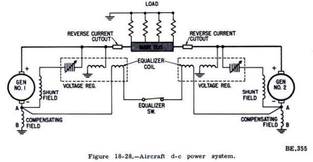

Twin piston engined aircraft routinely have two alternators online simultaneously and it is widely accepted that due to different set points on their respective regulators that only one with carry a load when both are operational. It is immaterial which.
This was a 'hard sell' for years after
alternators replaced generators. Generator
wear rates are related to ampere-hours of
service due to brush wear while alternator
wear is largely independent of electrical
demand in service. It was prudent to have
dual regulators 'talk' to each other to
balance the load between two generators.
[img]cid:.0[/img]
Equalizer busses are still present on the
starter-generators of some production turbine
aircraft.
