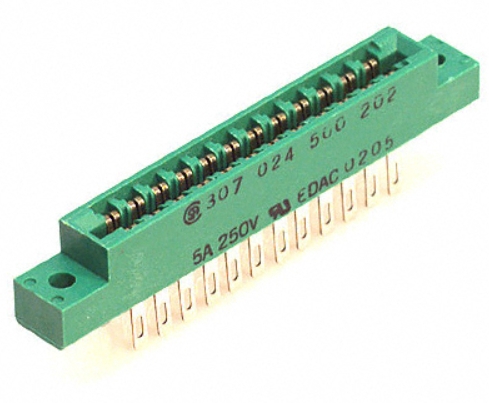

I do have some of these
[img]cid:.0[/img]
Which you can purchase here:
https://tinyurl.com/y98m7ph9
or I can send you one at no charge.
I'll dig around to see if I can find the
Molex KK pins.
