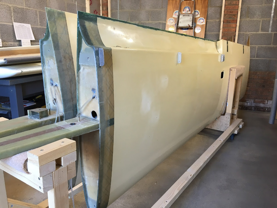

clivesutton
Joined: 23 Jan 2013 Posts: 187 Location: KENILWORTH
Posted: Mon Dec 10, 2018 1:23 am Post subject: Re: Wing storage |
Hello Eion,
If it helps, my solution is shown in the attached pic
Both supports are on 4 castors and on each, one wing cut-out is deeper than the other enabling storage with both spars together or opposed to aid of the available storage space. The two supports can be 'ganged' together with the horizontal strips of wood - to improve the ease of rolling the whole lot around, but i rarely find that extra precaution to be necessary.
The wing-shaped cutouts are deliberately inclined towards each other (upper surfaces face each other) to aid stability when stood outside unattended in a light breeze e.g. whilst you are waiting to put them onto or off of, a trailer.
Clive

eoinmaguire(at)hotmail.co Guest
Posted: Mon Dec 10, 2018 5:52 am Post subject: Wing storage |
Hi Clive
Looks great, I’ve got a few great options so far!
Eoin

sim(at)4lists.simonliebol Guest
Posted: Mon Dec 10, 2018 6:22 am Post subject: Wing storage |
Another solution attached. Not as nice but it works. I didn't build the
stands.
Simon
