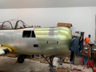

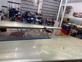

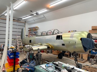

I have the new CJ stripped down. It took 36 hours but I have it all cleaned up. Now I need to talk to someone that has painted their own CJ. I have painted a few cars but never an airplane. I need to ask about what panels, if any, were left on what control surfaces were removed as well as basic technique for getting around the airplane while spraying. Also, the big one on how to keep the oil from dripping while it is painted and drying.
Please PM me if you can provide any helpful information at all. Even if you sent your plane off to be painted and know basically how they prepped it. This is a huge undertaking and I can’t afford to get it wrong.
Thanks a bunch,
SAM

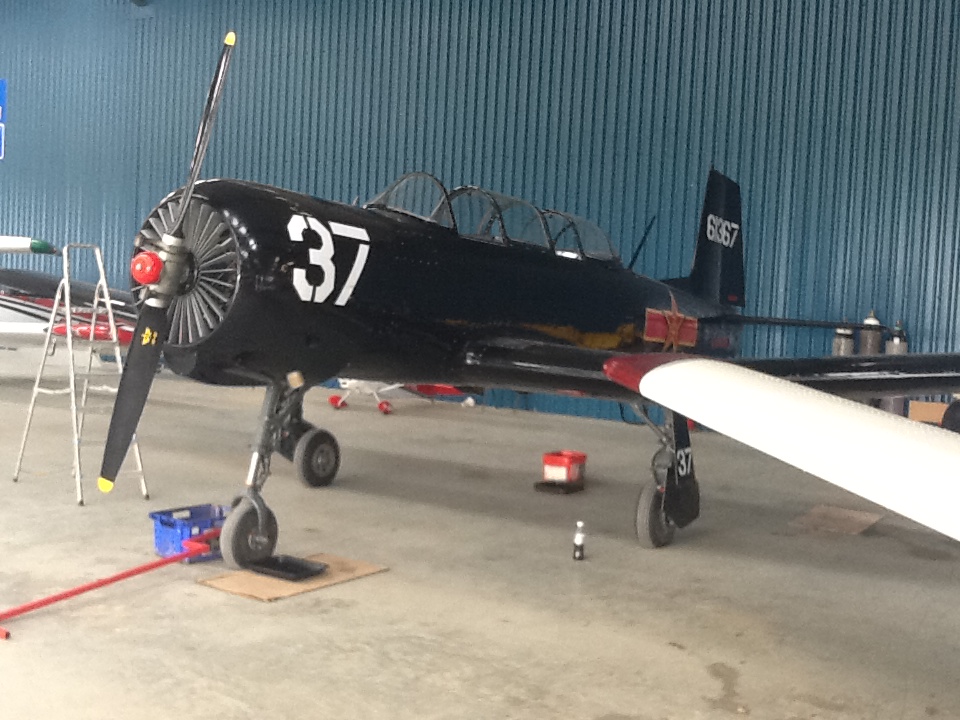

Hi Sam
I've been through this process and outlined a few points below.
All control surfaces were removed and stripped to replace the Chinese cotton which was redone with modern fabric (ceconite) and then silver doped. They were then high build primed and painted with modern 2k paint but with around 15% plasticiser added (important).
All removable airframe panels like hatches, cowlings, canopy frames (glass removed), wings, tail and all the gear legs and fairing were stripped and then painted with aircraft etch and zinc primer follow again with high build 2k primer and finally topcoat.
For all the top coats I found it easier to paint each wing one side at a time suspended vertically and this was the same for the rudder, rear fin and horizontal stab.
The fuselage as small as it can be made is still very big and I tackled this by masking off manageable sections along the natural skin joint and doing them in stages and then moving on to the next. Once a section is painted though you will need to mask it off otherwise overspray will ruin the finish.
Cowlings were done half at a time
All small panels were painted on the bench, hung up or held in hand.
Hope this helps
