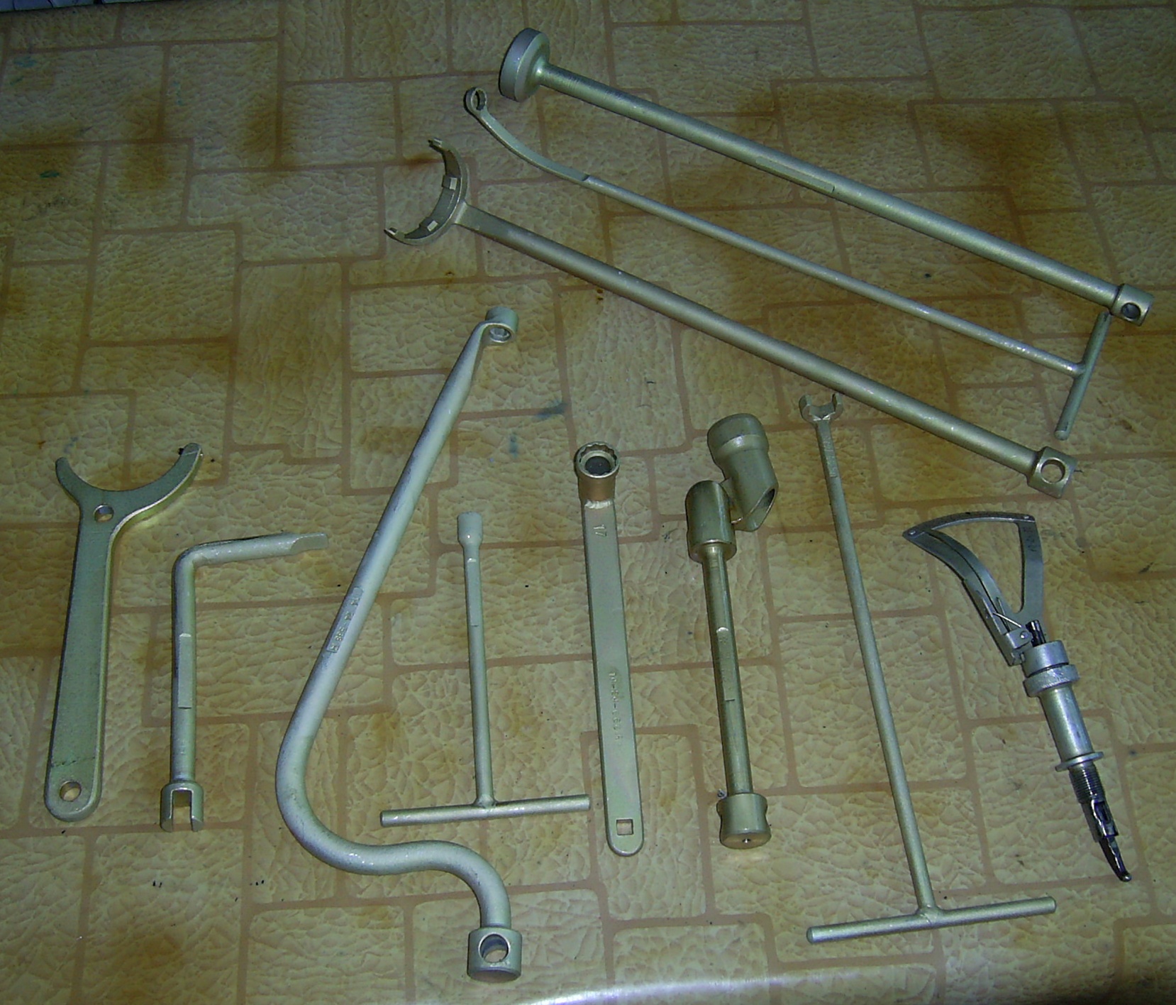

We have a limited quantity of these basic tool kits available at the
factory, but they aren't cheap $525 each plus shipping.

Sounds simple but now it get's interesting! Looking at the very nice photo
George supplied I fail to see a spark plug wrench (these are Russian but no
significant difference at all). So time to check out the HS6A Parts Cat.
Tools section. See pg. 259 and on. Fig 17 -1, Item 10 is described as a
"spark plug spanner". This is exactly the same tool as shown # 6 from the
left in George's photo. Well I'll be damned! The real Chinese spark plug
wrench des not apparently exist!
I have two or three of these laying around the hangar. They sure enough are
22mm and fit the spark plug but as a spark plug wrench they are virtually
useless particularly for #6 rear. In fact I have found no use for them at
all.
My guess is the Chinese Air Force grunts agreed with me and designed a tool
that actually works! In which case my good buddy Doug will know all about
this and get some in stock. They are not really necessary but are very
convenient for plug removal.

"Spanner for spark plug of cylinder no.6" is shown in my version of the IPBs on page 122 of book #3, figure 2-7.
On the web site CJ6.org it is shown in book #3, but on page 126, which means that there are at lease two maybe 3 different iterations of the CJ6 parts books out there.
