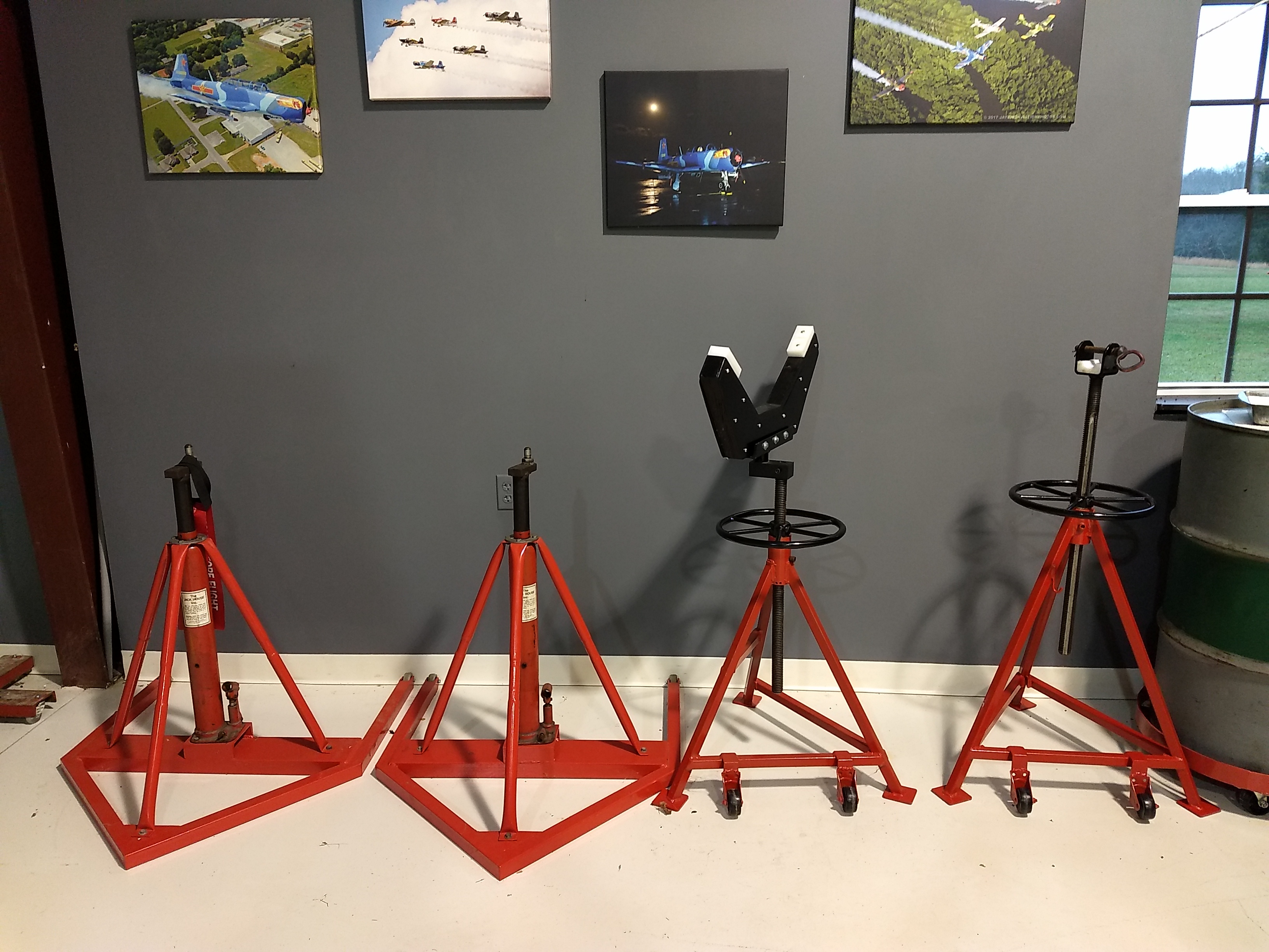

Here is what I have had fabricated over the last 2 years for CJ.

Here is what I have had fabricated the past 4 years.

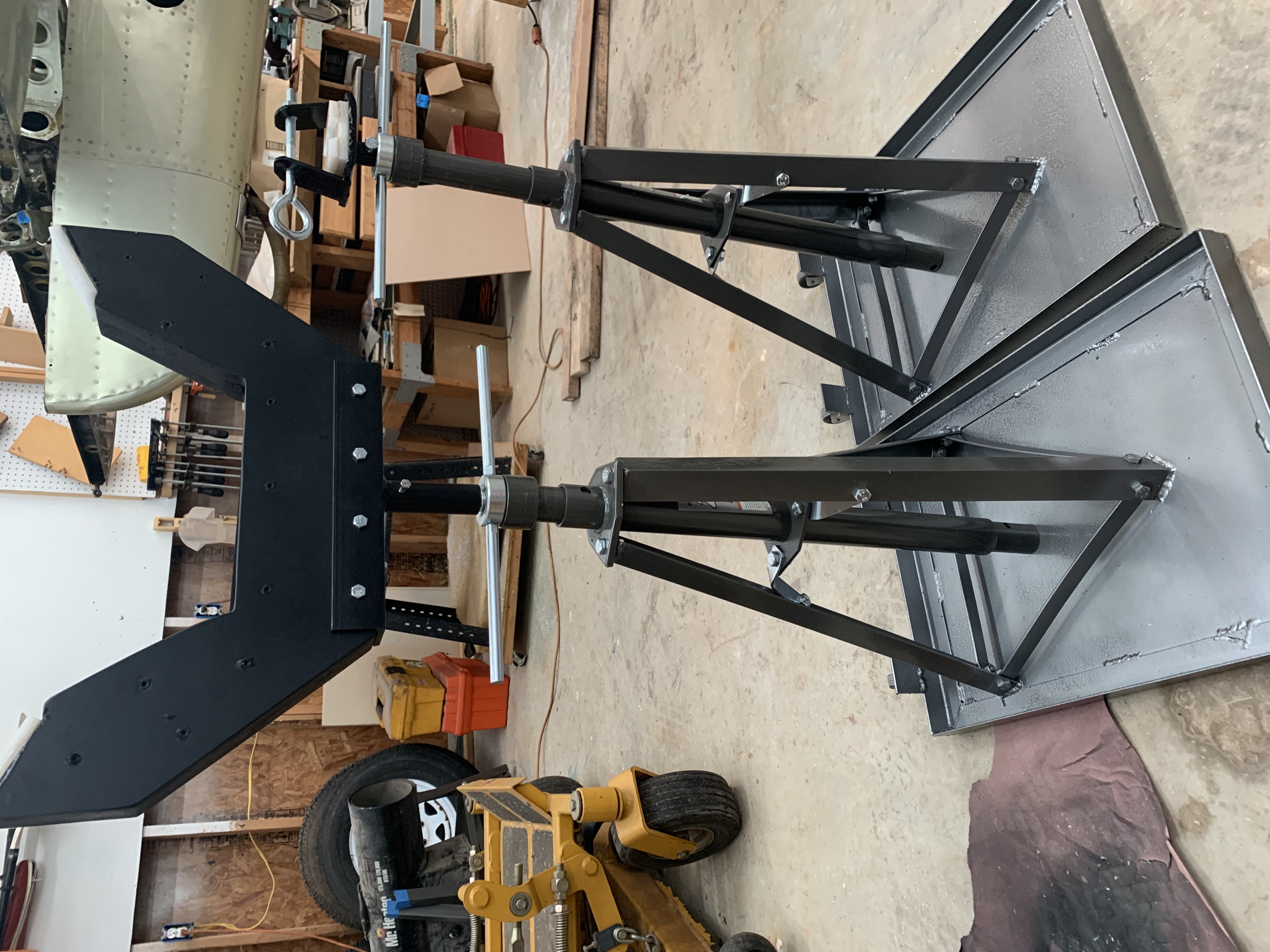

Just letting you guys know that I fabricated my nose and tail Jack’s. Here’s how they turned out. In case you guys out there need a set. Maybe it will give you some ideas.
