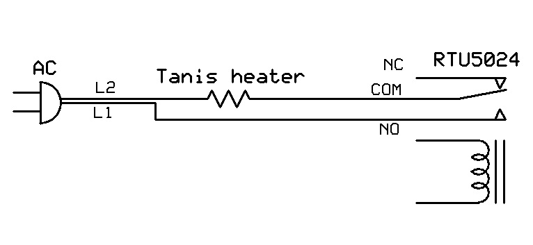

Here is a schematic diagram.
I assume that the relay is built into the RTU5024.

How many watts is the Tanis heater? If it is 400 watts or more, then a heavy duty relay needs to be added.

Joe, the Tanis is only 230 watts, but I'm reluctant to use the RTU5024 as the main relay. I was planning to use a separate heavy duty relay for the main relay, and use the RTU5024 to control it. Can you show me how I would do that (control a relay with a relay)? Also if you could give me a Mouser part number for an appropriate relay, that would really fix me up.

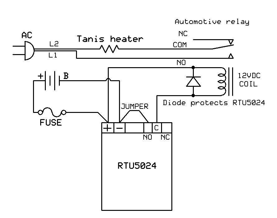

You can buy a 30 amp relay at an auto parts store.
Ignore the B beside the battery.

Okay, so an automotive relay like we would use on our airplanes would be okay for this application, too. I have a few lying around.

PostPosted: Wed Dec 05, 2018 4:47 am    Post subject: operating a relay with a cell phone Reply with quote
Well it would work.
But would not be legal or particularly fire safe as it certainly isn't
rated for 120 volts. Definitely the kind of thing that an insurance
investigator likes to find. Of course turning on any kind of heating
device when no one is around entails some risk anyway...

The S704 style plastic relays are quite
suited to this task. According to the
users manual, output from the device
is a set of form-c dry contacts rated
at 3A so a 'buffer relay' is called for.
Consider a solid state device like this
https://tinyurl.com/y9qh9wq4
You can use the n.o./common contacts
of the receiver to control power to
the SSR input. You can 'steal' power
from the same supply that operates the
receiver.
There are no regulatory issues (aside
from local fire marshals) for this
project. If it's not bolted to the airframe,
it's of no interest to the feds.
I'd mount the receiver and solid state relay
on the wall of the hangar and provide an
outlet to an extension cord that powers
the Tanis heater in its normal operating
configuration. Risks (beyond failure to
function) are zero.

Okay, when I started this I thought, like Barry, that a second relay would be required. But thanks to Joe I now understand that the RTU5024 is well rated (3A/240AC) to handle the power required by the Tanis (2A/115AC) and so I will wire it up as he suggested, directly untilizing the relay in the RTU5024. Makes the whole thing much simpler. Thanks Joe.

Okay change of plan, thanks much Bob.
Ken
On Wed, Dec 5, 2018, 06:58 Robert L. Nuckolls, III <nuckolls.bob(at)aeroelectric.com (nuckolls.bob(at)aeroelectric.com) wrote:
At 06:46 AM 12/5/2018, you wrote:
--> AeroElectric-List message posted by: Ken <yellowduckduo(at)gmail.com (yellowduckduo(at)gmail.com)>
Well it would work.
But would not be legal or particularly fire safe as it certainly isn't rated for 120 volts. Definitely the kind of thing that an insurance investigator likes to find. Of course turning on any kind of heating device when no one is around entails some risk anyway...
Ken
  receiver.
  function) are zero.
PostPosted: Wed Dec 05, 2018 10:45 am    Post subject: operating a relay with a cell phone Reply with quote
Opps . . . the Tanis only take 2A? Hmmm . . .
one COULD use the receiver's built in
relay although I'd still tend toward adding
the buffer relay with the following caveats:
Current through the receiver's relay contacts
is VERY low when driving an SSR . . . after some
period of time in service, corrosion build on
the receiver relay contacts MIGHT cause the
n.o. contacts to go 'open'. Not likely but
still something to throw in the trouble-shooting
bucket if the critter quits.
If you elect to use the built in relay, then
contact 'cleaning' will not be an issue. I
think I'd add a 5A fuse in series with 120vac
power to the Tanis . . . if for whatever reason,
current in that loop is faulted, it would
be cool if the event didn't smoke the internal
relay (probably not easy to replace).
Hmmmm . . . only 250 watts to heat the engine?
My propane 'dragons' on K1K1 certainly put out
a lot more heat but they had to play catchup
in minutes. 250W continuously applied over-night
may well be enough. Learned something new today.
