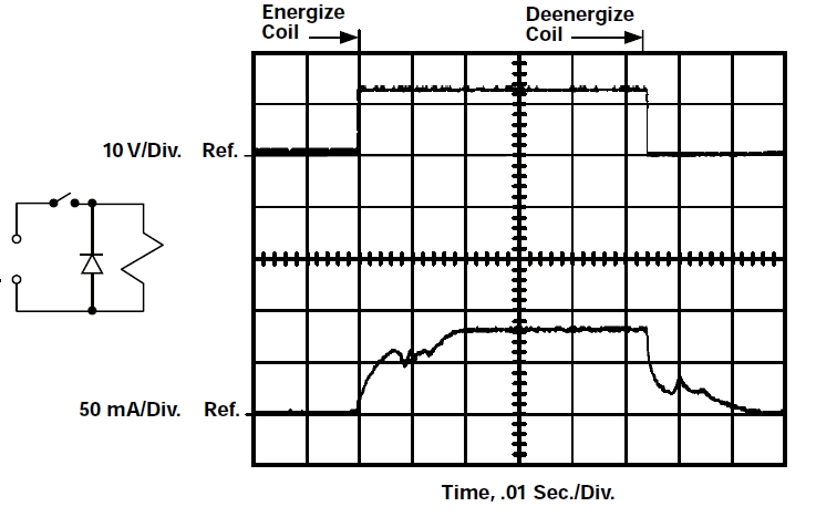

PostPosted: Mon Oct 22, 2018 10:10 am    Post subject: Stuck starter questions Reply with quote
How well does the diode prevent this from happening? Is there a way to tell if the diode has failed open-circuit?
The diode across the coil of a contactor has no
significant effect on the life of that device's
contacts. An often quoted document by Potter and
Brumfield claims that coil suppression techniques
can have a deleterious effect on contact life.
https://tinyurl.com/yayk835c
One of several exemplar figures is shown below:
[img]cid:.0[/img]
When this document was first cited on the AeroElectric List,
I went to the bench and captured some relay performance
traces of my own:
http://aeroelectric.com/articles/spike.pdf
https://tinyurl.com/yb6s6l7c
www.aeroelectric.com/articles/spikecatcher.pdf
I'm mystified by the trace pictures in the P&B
document. They fail to illustrate any drop-out-delay
caused by addition of the simple catch diode.
At the same time, the figures and text purport to
show how coil suppression techniques can affect
CONTACT SPREADING VELOCITY which is the critical
to contact life. They also fail to show any
contact bounce on closing. If I were a physics
prof grading these illustrations as part of a
student's work-product, I would ask them to
'show me' back in the lab.
I was able to show that contact spreading velocity
does not change appreciably with variations in
coil suppression technique (for reasons that
have to do with MAGNETICS and little to do
with coil current).
The short answer is, worrying about the diode
is not useful. They seldom fail and when they do
fail, they'll fail shorted . . . not open . . .
and may even blow apart as noted by another Lister.
The PRIMARY reason for contact welding is a soggy
battery. So if your starter fails to get the
prop whipping around right smartly . . . STOP
and charge/replace battery or plug in ground
power.
