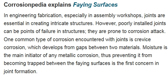

And what 'faying' surface are you talking about? Look up the definition of faying.
These are Grounding Points, not assembly points.
Okay . . .
[img]cid:.0[/img]
Preventing 'crevice corrosion' by exclusion of moisture
and air into GAS TIGHT joints is what we're talking
about here . . . and it is not unique to structural
joining.
