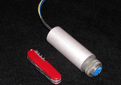

One of the last noise issues I worked at Beech was
a newly qualified cabin HVAC system wherein the
rear mounted blower hosed the ADF.
Ran the blower in our lab and found it to be
exceedingly noisy.
This device was recently 'qualified' by a lab in
Dallas. I drove down and visited the lab. Looked
a their test set up and talked with the test technician.
Looked at his test data plot. "Wow", says he, "this
the the quietest motor I've ever tested". To be sure
the plots didn't rise off the receiver's noise floor!
We poked around the EMC test cell and found that the
coax through the wall to their conducted noise
transformer had been disconnected . . .
Fortunately, there were only about a dozen products
they had erroneously holy watered in that test
cell . . easy to spot in the test data. The
test technician wasn't experienced enough to know that
the noise was never zero. It just had to be below
a pass/fail line.
We had a dozen systems in the field. Modifying
the blower would call for re-qualification. Made
a midnight run to Captor Corporation where
a fellow gray-beard and I crafted a filter-connector
to go on the end of the harness that mated with the
blower.

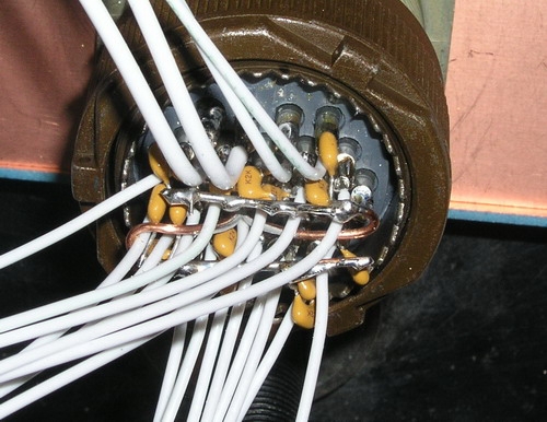

Had to do this kind of thing on another airplane
where vintage starter-generator controllers (never
qualified to modern design philosophies) needed
a bunch of capacitors installed under the
connector back shell.
[img]cid:.1[/img]
These noise problems were the result of poorly
designed and/or qualified devices. The fact
that they were fielded made it necessary to
craft 'band aids' to bring them into compliance.
