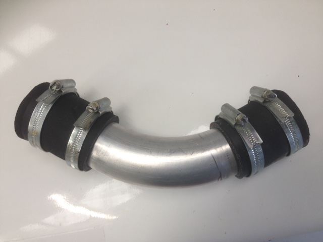

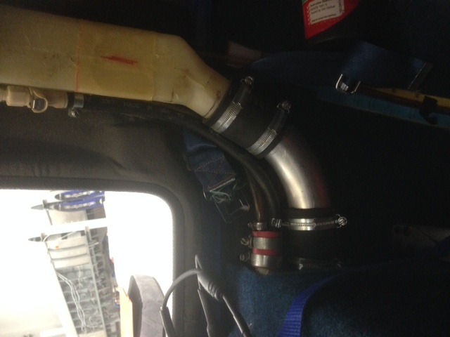

Posted: Tue Sep 04, 2018 11:49 am Post subject: Aluminium Fuel Pipe |
Hi Europaeans,
Only got two left which I can bring with me to post to the USA, or Canada, and then on to the UK next week.
This is most likely the last batch I will do.
UK LAA approved. £25 plus postage
See UK Europa Club website for details under:
https://www.theeuropaclub.org/the-club/sales-and-spares-member-adverts/xs-aluminium-fuel-bend

I got a 60° elbow silicone fuel resistant hose with 15cm legs manufactured from Samco (bought via Merlin Motorsports) to replace the original rubber hose. The legs can be cut to length if need be. It costs 67,96 GBP + VAT + shipping.
This way you avoid additional connections. The fuel smell in the Cockpit was gone.

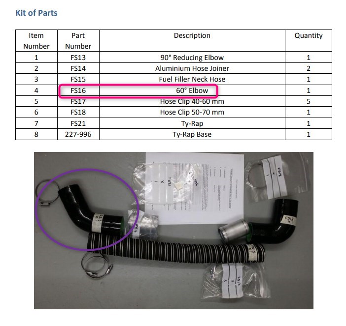

Europa also supply a silicone elbow (FS16) as part of Mod 79 (http://www.europa-aircraft.co.uk/updates/mods.php) or (http://www.europa-aircraft.co.uk/upload/Modification%20Bulletin%20No%2079%20(Issue%2003).pdf)
It's about GBP46 + shipping + VAT... might be worth a call...?
