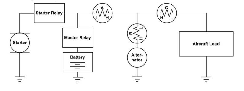

Myron, based on your description, I agree that the aux alternator is putting out 7 amps. Perhaps the alternator is not spinning fast enough to generate its rated capacity.
Looking at the attached picture from a Dynon manual, confirm that the shunt is in location A, and not B or C.

Joe Gores
PostPosted: Sun Sep 23, 2018 9:36 am    Post subject: Alternator/shunt question Reply with quote

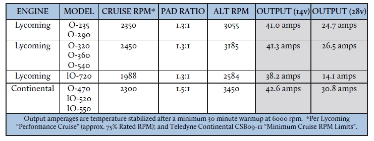

Do I assume correctly that we're talking about a
BC-462 alternator? Referring to B&C published data . . .
[img]cid:7.1.0.9.0.20180923122834.05fbf240(at)aeroelectric.com.0[/img]
. . . the alternator is capable of at least 40A of
output at nominal cruise rpms on any engine. Assuming
that your current sensor is indeed installed as
a battery ammeter -and- you're seeing -2A with the
standby alternator ON, then we have to deduce that
your bus voltage under this test condition is WAaayyyy
too low . . . the battery is still supply a portion of
the ship's running loads.
You did not mention any observed voltage readings and
as Joe suggests it would be helpful to confirm the
actual location of your Dynon sensor in the system.
What votlage regulator are you using on the standby
alternator? Adjustable? Was it checked and adjusted as
necessary at time of installation?

The reading in flight is 14.3 VDC and 1 amp with primary operating.
It is 12.5 VDC and MINUS 9 A with both Alts off
It is 12.9 VDC and minus 2 A with the backup only operating.
SB-1 is set too low. It only needs to be 0.7v or
so below your main alternator set point.

Myron,
From your description, I deduce that the shunt is located in position "A" in the picture in my previous post. All voltmeter and ammeter indications are correct. Like Bob said, the standby alternator voltage is set too low. I suspect that on a long flight of an hour or more with the main alternator off and the standby alternator on, that the voltage will go down a tenth or two and the amps would slowly rise from -2 to zero. You could leave it like that, but the battery will not be fully charged at your destination. It is best to increase the voltage of the standby regulator like Bob said.
Joe Gores

Thanks guys. I tied the standby into the shunt simply because it was an easy and efficient way location wise to tie it to the “system”, and I hoped it would still provide some useful information.
