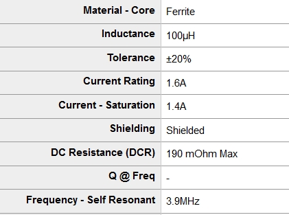

The components cited in the DIY article for
filtering this device are problematic. Since
our spectrum of interest is VHF, electrolytic
capacitors are definitely contra-indicated.
The inductor cited has some characteristics
that are also problematic
[img]cid:.0[/img]
Since this is a 18w device powered by what
has to be a constant current generator with the
10 to 30v input range, current draw at 14
volts can be estimated as (18w/14v)/0.8
estimated efficiency equals 1.6 amps.
While the 'rated' current for the device
is 1.6A (meaning it won't burn up) the
'saturation' value for the device is
1.4 amps . . . meaning that its inductance
goes to zero at or above 1.4A.
I have no doubt that the design offered in
the DIY article had some beneficial effects
but it was not optimized for the task. There
are dozens of more suited devices of this
is one example:
https://tinyurl.com/y8nrz56k
Rated at 5A continuous, it has a nice
impedance peak at 100 Mhz (our spectrum
of interest). Now we want to team this
with capacitors that are similarly
suited to VHF energy management. A
capacitor of 1000 picofarads has an
impedance on the order of 1.6 ohms
at 100 MHz. An exemplar component . . .
https://tinyurl.com/yd3bh98e
These are candidates for a noise abatement
experiment. Suggest the pi filter configuration
with filter mount on shortest practical leads
at the back of the lamp assembly. Since this
device has a metal housing, suggest the black
power lead be grounded to that housing along with
the 'ground' leads of the two capacitors.
It may well be that the noise problem is a
combination of conducted and radiated so a
power line filter may not completely tame the
beast but this is a place to start.

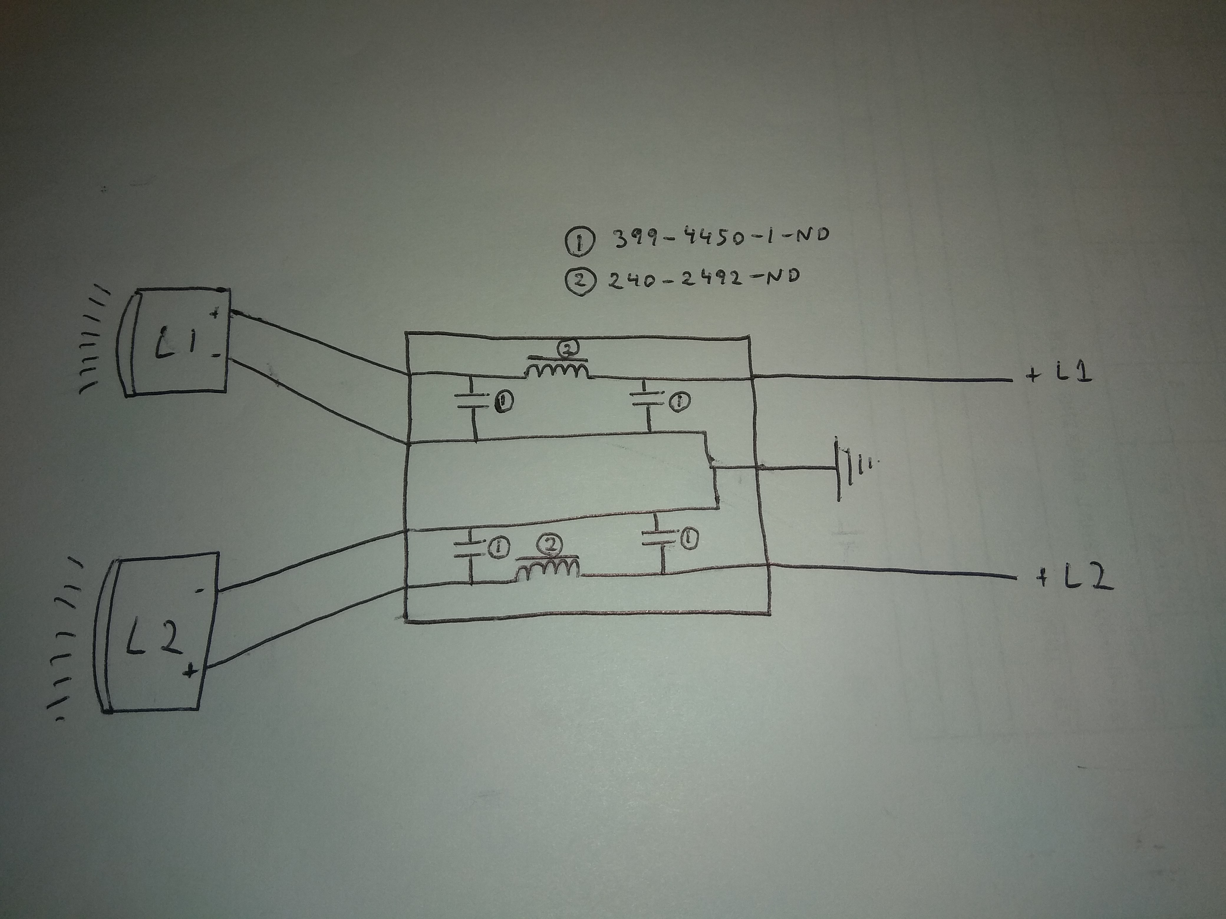

cluros(at)gmail.com
PostPosted: Sun Sep 30, 2018 10:07 am    Post subject: LED Noise Filter Reply with quote
I was wondering about the radiated vs conducted thing but was thinking since it doesn't have any properties of an antenna any radiated noise must radiate from the wires. Further thought makes me realize this makes no sense since the lights are physically connected to a big metal wing and in any case no antenna is necessary to create a VHF signal that travels 15'.
Since we have 2 lights per wing, I'm planning on making a little box with short leads and a plug for each light. See diagram below.
Bob I'm unsure what you mean by the black power lead being grounded. Unfortunately the aircraft wiring does not include a ground wire to the forest of tabs ground bus behind the panel and simply grounds to the wing. I think you mean I should run a wire from each housing to a common ground point with the ground on my diagram. Is this correct?
[img]cid:ii_jmp6am4p1[/img]
On Sun, Sep 30, 2018, 09:00 Robert L. Nuckolls, III <nuckolls.bob(at)aeroelectric.com (nuckolls.bob(at)aeroelectric.com)> wrote:
At 11:12 PM 9/29/2018, you wrote:
https://www.amazon.com/gp/product/B01KJ94Q1K/ref=oh_aui_detailpage_o01_s00?ie=UTF8&psc=1
If they were the +$300 ones made for aircraft I would call the manufacturer but these are 15% of the price of the aviation ones so I understand why the builder chose them. If we can fix this for $20 worth of parts it makes sense to me.
  Sure . . . didn't know which product we're
  discussing . . . wanted to know if we
  were talking a COTS product or and
  entrepreneurial offering to the OBAM
  aircraft community.
  is one example:
