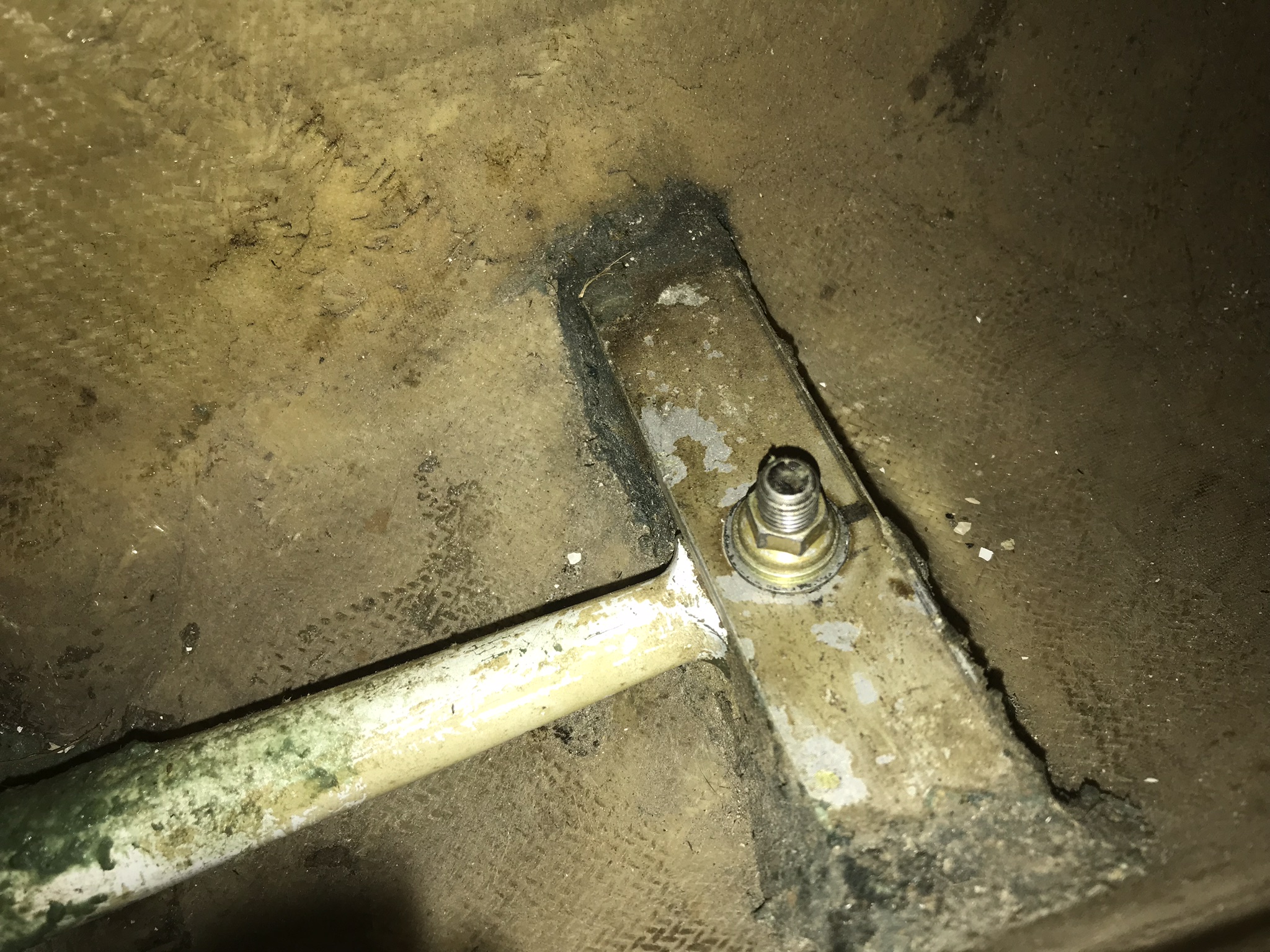

This is my slightly modified tailwheel spring front mounting bolt arrangement. An extra piece of aluminium across the top with redux/ flox built up either side of the spring to support it. The extra top piece of aluminium is permanently fixed in place and the spring just slots snugly in place under it. Easy to remove the spring, once the bolt is removed it just slides out backwards. Been good for many years now.

It looks as if you both came to the same solution with differing ways to do it. Both good and a great improvement on the standard design.
Barry

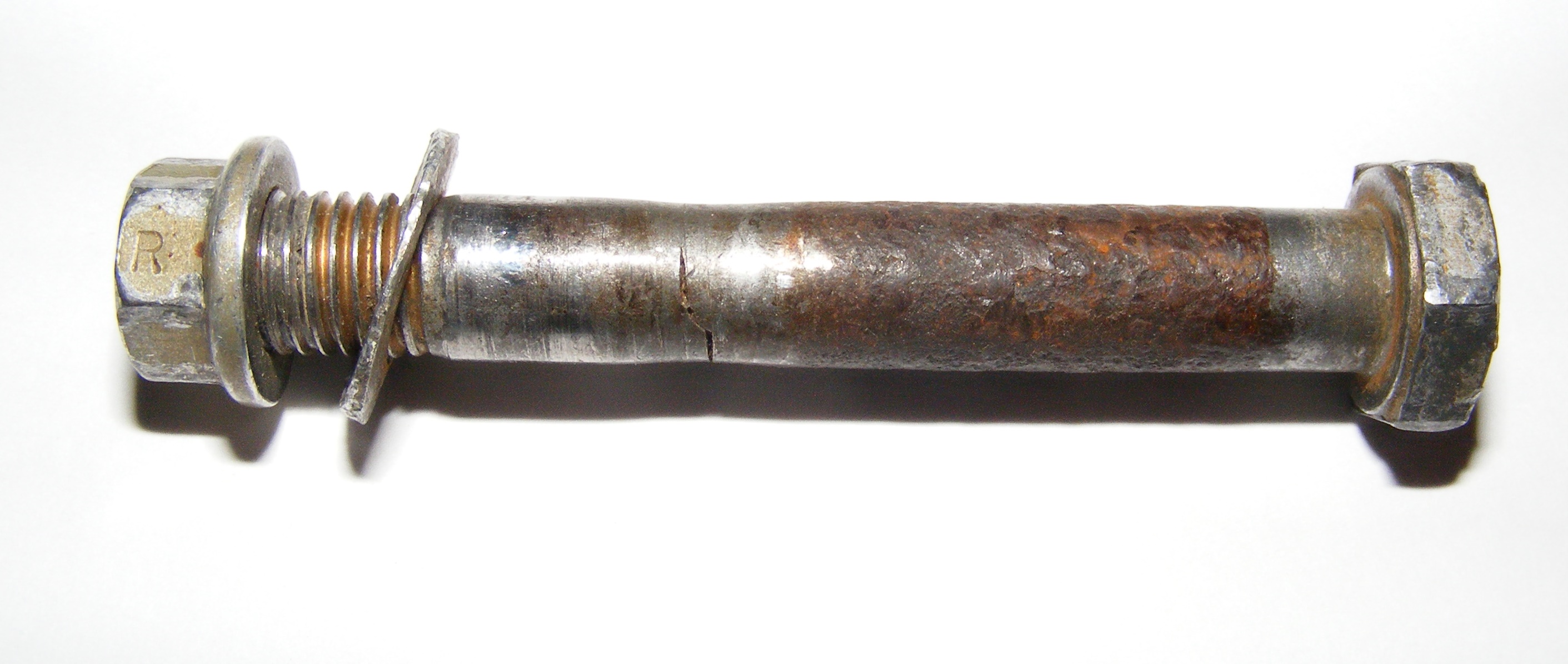

The bolt failures are the symptom of the problem – not the cause!
The problem is the plywood stack that the tail spring sits on. During the build, the plywood is sheathed in waterproof epoxy, but then you have to drill the hole for the bolt to pass through, exposing the wood to the atmosphere – and THAT is the problem.
In service, moisture wicks up the bolt and into the plywood end grain, where it sits unseen. Eventually the wood begins to rot and the structural rigidity is lost.
At this point, the clamping force of the bolt is lost and the spring begins to rock from side to side during taxying.
This allows the bolt shank to fret and eventually the fatigued bold will fail.
I have attached a picture of a tail spring bolt that was replaced just in time (the ground handler noticed the tailwheel flopping from side to side during taxying).
This shows everything; the deep pitted rust indicates that the plywood stack was wet, the fretting has worn away the blot shaft where is passes through the end of the tail spring, and you can see the fatigue crack developing nicely.
Simply replacing the bolt will cure the symptoms, but it will eventually fail again in exactly the same way.
To affect a lasting repair, the plywood should be thoroughly dried out and then impregnated with a thinned epoxy resin to restore the structural rigidity.
To keep the bolt shank away from the wood, I over bored the mounting hole to accept a 5/16” bore 4041 sleeve, which was bonded permanently in place. The new bolt was then greased and inserted through the sleeve.
I also made up a steel saddle bar that sits on top of the tail spring mount to prevent it from rocking (just like Jon’s).
Nigel

A nice description of the cause and effect.
The actual root cause is poor design. A Design which takes rolling loads as differential bending would be so much better. This could be achieved with 2 bolts although it would need a T shaped end.
A fully bushed insert would also relieve bending in the bolt.
Design is so much easier with hindsight.

A good synopsis Nigel. My bolt was nowhere as rusty as yours, just showing a light surface corrosion, but the root cause is certainly the ability of water to ingress into the wood allowing bending of the bolt.
I have 2 Kg of lead in my tail to compensate for the weight of my MT prop. so I can build a solution that will last forever!!
