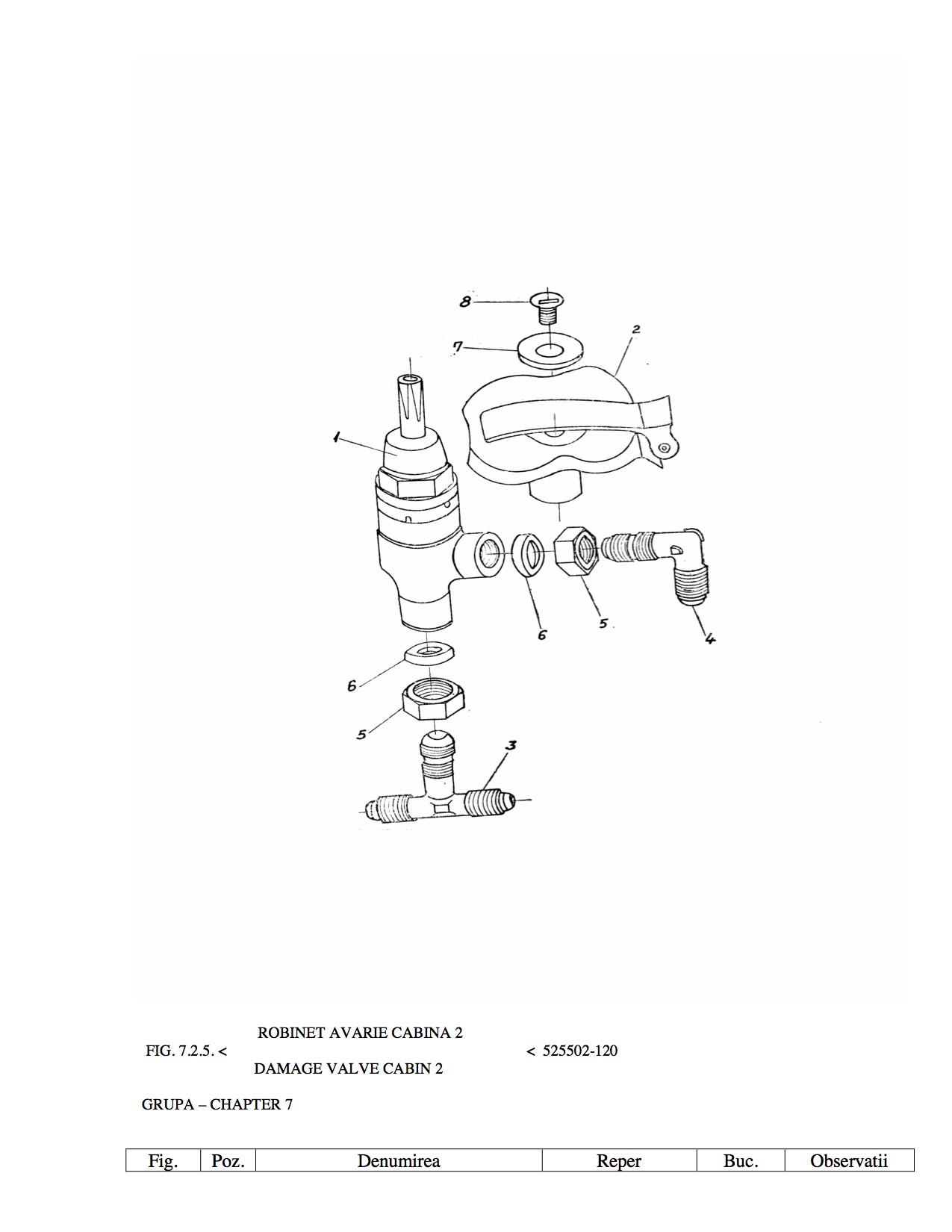

In almost 20 years, the only leaks I have had on the emergency side were at the emergency valves in the cockpits. There is a square o-ring, #6 in the attachment; this has always been the offender.
 Filesize:  126.65 KB
 Viewed:  9537 Time(s)

True. Where did you find the square O rings.
Doc
Sent from my iPad

I had a lifetime supply given to me by another Yak friend.
Basic dimensions are -
14.5mm OD
9.5mm ID
2.5mm height
I'd try Mcmaster if I were on the hunt.
