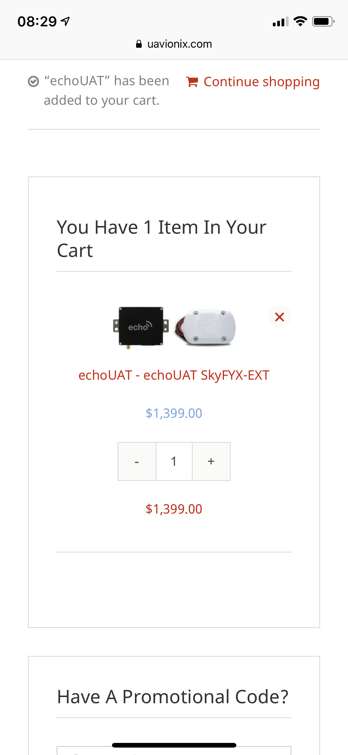

[img]cid:2B5F5C84-FC59-4AD2-956A-BAEAADD42858[/img]
The echoUAT Might make for a much more simple install. Also 1399 with the dash mounted GPS receiver antenna combo.!
