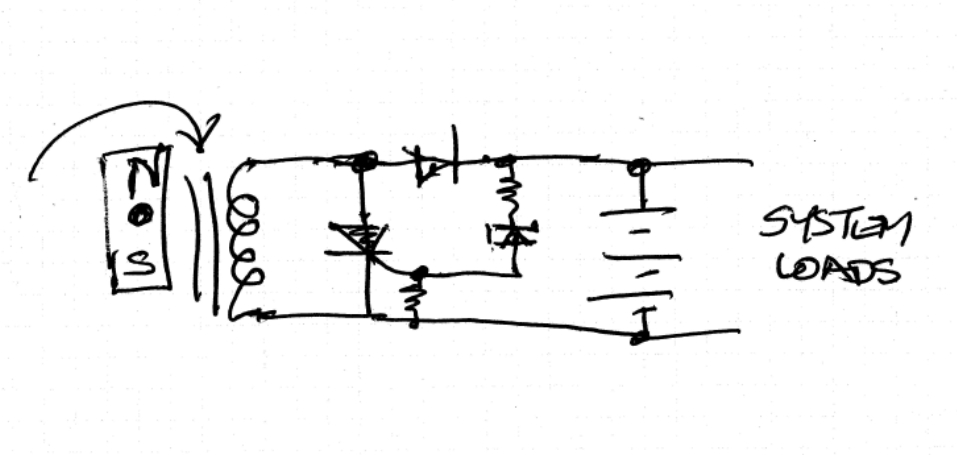

PostPosted: Sat Aug 25, 2018 6:02 pm    Post subject: Jabiru 3300 voltage regulator Reply with quote
At 12:43 PM 8/24/2018, you wrote:
I am helping a friend install a Jabiru 2200 on an Excalibur light sport airplane that has a much simpler electrical system than you are building. I checked the Jabiru manual and found that they are using a permanent magnet alternator with single phase AC output. The regulator that Jabiru supplied with the engine is the type that puts a full load on the alternator at all times then rectifies the output and regulates it down to 14 volts.
This 'shunt regulation' philosophy for small engine
PM alternators was indeed popular and practical when
mini-bike builders wanted to add batteries and headlights
to their products. Total system energy requirements were on the
order of 10 watts or less . . . not unlike that produced
by those little generators we used to put on our bicycles.
The had to be designed to tolerate continuous short
circuit loading. I.e. wound with smaller, high resistance
wire and well heat-sinked to dissipate the energy developed
when a battery became fully charged and the shunting device,
usually an SCR, was triggering early in every half cycle of
the dynamo's output. Simple and sorta worked purddy gud . . .
[img]cid:.0[/img]
Then came snowmobiles, ski-doos, etc, etc and the batteries
got bigger, lights more powerful, starters were added, etc.
etc. But the common vernacular for the ac dynamo on the engine
was a 'lighting coil'.

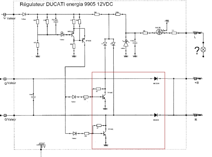

(1) is where you start from.
[img]cid:.1[/img]
The legacy, gated full wave rectifier shown above is
typical of most if not ALL rectifier regulators of 20
or so years ago. Some people have mistakenly called this
a 'shunt' regulator because of the totem-pole of rectifier-
SCR strings across the alternator winding. It may LOOK
like some kind of 'shunt' circuit but in fact, those
four devices in the bridge are only turned ON in pairs
and in series connection with the alternator winding.
The 'transistors' you see above are in fact 4-layer,
triacs or scrs. They are the major heat dissipating
devices in the circuit. Some manufacturer's have
eliminated the 4-layer devices in favor of MOSFET
transistors which typically have perhaps 5% of the
dissipation of the SCR. These modern R/R's run much
cooler and are more efficient.

I'll bet the Jabiru 3300 R/R is no different electronically
than the Ducatti regulators supplied with Rotax engines all
these years.
