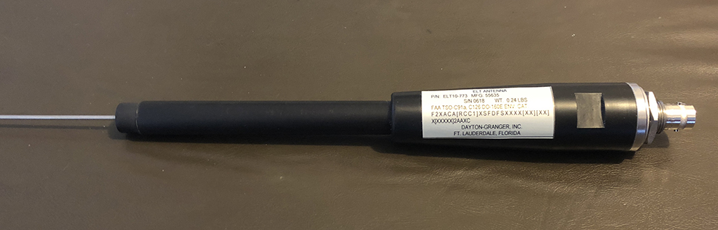

My part number is ELT10-773 for a Kannad Compact if you want to look up a pic. I believe these ELT whip antennas are base-loaded, meaning the Acetal plastic base is also generating signal and should not be shielded by a metal fuselage.
I don’t want all that thick antenna base hanging out in the breeze. For this reason I have installed mine in the dorsal fin, but with the empennage fitted I can’t reach into the fuselage from the back to uncouple the coax BNC, so I need to make a doubler in the skin to unscrew the mount from above. This requires taking the dorsal fin off, which puts some pressure on the antenna base and causes some flex in the skin (cos it wraps around the leading edge of the horizontal stab). I would like to make a flex joint to stop the skin movement, but I suspect this antenna requires proper grounding to a ground plane just like a COM antenna.

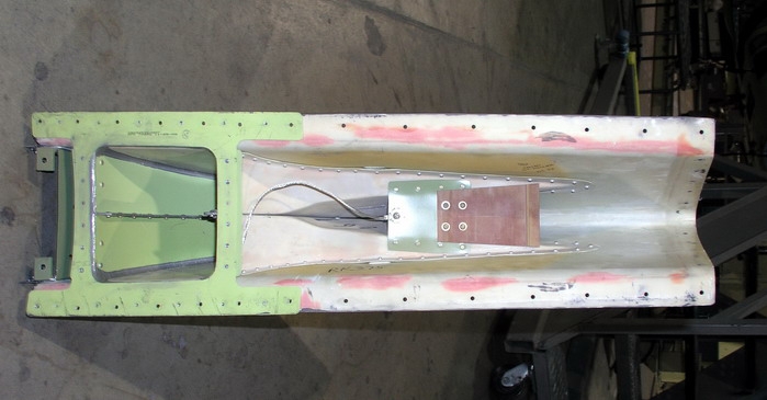

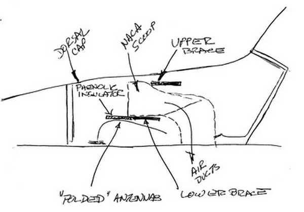

Back in 2004, I wrote about a kerfuffle with elt
antennas on the Beechjet. Seems that somewhere along
the history of this installation, somebody decided
that it would be really cool if the antennas could
be totally enclosed under the dorsal fine toe fairing.
[img]cid:.0[/img]
This situated the antennas in close proximity to
metallic obstructions to idealized radiation
patterns. Another insult to performance was
perpetrated by a fiberglas cover which was
was host to some inlet air ducts for the
HVAC system.
So they added a metal bracket (which had to be bonded
to structure for lighting issues) to mount a phenolic
block intended to conform the antennas to space
under the fairing by deflecting them down and aft
against the phenolic block.
[img]cid:.1[/img]
[img]cid:.2[/img]
This work-around was no doubt enthusiastically
accepted by everybody but the ELT manufacturer. I
was unable to locate any documents that described tests
of this installation wherein performance degradation
was deemed acceptable.

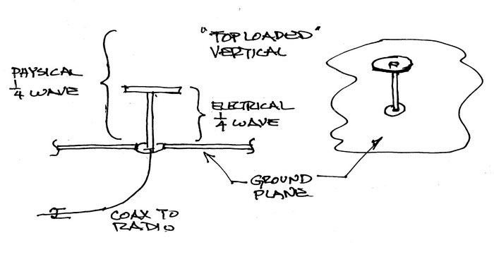

The problem didn't come to the attention of the
ELT manufacturer until some of their more agile
products began to complain about high SWR. I
proposed that the stock antenna be replaced with
top loaded verticals that were not only mechanically
shorter but tailored to accommodate the proximity
effects of local conductors.
[img]cid:.3[/img]
However, this was a TSO'd installation holy-watered with
the as-supplied antennas.
Tailoring new antennas to the installation would require
re-certification of the ELT. But there was silence when
I inquired as to how badly the TSO was being compromised
by the non-standard installation of the stock antennas.
The 'fix' was to change software in the ELT to accept
higher SWR values . . . seems that didn't disrespect
the TSO . . .
Bottom line is that the lion's share of radiation
flux from these antennas comes from the bottom third
of the antenna . . . the area where the highest currents
are found. This means that 'top' loading as illustrated
above does not seriously affect antenna performance but
it does narrow bandwidth . . . not a big deal for
single frequency operations.
So while deliberating ways and means of getting the
stock antennas situated for best esthetics and/or
aerodynamics, be aware of potential distortions of
radiation patterns and performance. Be aware also
that without instrumented investigation of performance,
any opinions as to the effects of non-standard
installation are more guess than fact.

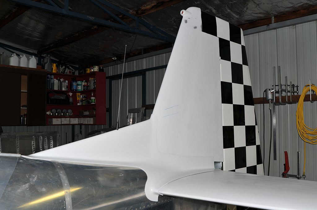

I have some interest in that top loaded antennae you depict. I mounted my whip antennae on the belly of a Zenith 601XL, in order to remove the interference that it had with my comm antennae. Well, now it almost drags the ground. Not a good thing on a grass strip. It would be nice to have a shorter antennae.
With that being said, I'm firmly in the camp of not ever expecting to rely on an ELT for anyone to find me.  It's there and operating for legal compliance and nothing else.
[img]cid:.0[/img]
 HVAC system.
[img]cid:.1[/img]
[img]cid:.2[/img]
[img]cid:.3[/img]

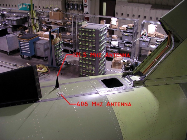

[img]cid:7.1.0.9.0.20180816143700.06f6ab58(at)aeroelectric.com.0[/img]
That 'towel bar' antenna just above the windshield
was part of the search and rescue hardware in
use by military, CAP and an, no doubt a few
well heeled commercial ventures.

stuart(at)stuarthutchison
PostPosted: Thu Aug 16, 2018 3:45 pm    Post subject: ELT antenna Reply with quote
Thanks Bob.
Could you confirm please that the threaded metal mount of a base-loaded 406MHz ELT antenna should definitely have some ground plane like a COM antenna? Pictured below is my current installation and the ELT antenna, but I need to add some flexibility to the attach point in a small space on the upper surface of the fuselage without compromising grounding (I think).
Also, as a former principle RAAF SAR Officer (USCG and USAF trained), I should add a few comments about 121.5 and 406MHz beacon safety that I think our aviation community might benefit from:
Old system - 121.5 / 243.0 MHz
1. 121.5MHz satellite COSPAS/SARSAT reception (payloads piggy backed on NOAA satellites, among others) primarily used doppler shift (frequency change, much like the sound of a train approaching, passing and leaving you) to determine the abeam point (centre frequency) during each satellite pass. Unfortunately, there is an abeam on both sides of the satellite path, so multiple passes were required to resolve the fix ambiguity. While there were lots of satellites fitted with this payload, it could still take as long as 12 hours to achieve multiple passes and a decent search datum to launch SAR assets to. In fact, when a C-130 crash position indicator was popped off the tail around Cootamundra (near Canberra, Australia), it still took nine hours for COSPAS/SARSAT to provide a start datum, despite knowing where to look.
2. 121.5MHz beacon frequency stability was relatively poor, meaning establishing centre frequency was inaccurate and the possible datum ellipse was commensurately large (not so great for limited SAR resources).
3. The approximate 121.5MHz position was then used to for local Direction Finding via other platforms.
4. The COSPAS/SARSAT network was highly susceptible to false alarms triggered by stray RF. Approximately 95% of alerts were false the world over, meaning already resource limited SAR assets were being wasted and potentially denying people in real need.
New system - 406.025MHz
1. 406MHz signals are digital and it incorporate a unique HEXID, which is 15 digits long. It can be appended with all sorts of information in a long or short message format. Geostationary satellites can collect this information and the Rescue Coordination Centre immediately knows (from the registration database) whose ELT is active. Form the database they can obtain your contact details and call you or your nominated alternative points of contact.
2. If your 406 ELT doesn’t have a GPS input (either an inbuilt GPS receiver, or GPS feed signal from the NAV system onboard your aircraft), then Low Earth Orbit (LEO) satellite passes still take time to conduct doppler analysis for position. However, the frequency stability of modern 406.025MHz ELTs provides a much smaller ellipse of about 5km. 406 beacons must still have a 121.5 swept tone signal for localised rescue platforms to direction find, but that the COSPAS/SARSAT detection of 121.5 was switched off back in Feb 2009.
3. If your 406 ELT does have a GPS input (highly recommended option), then the position is appended to the long message digital broadcast and is received by the RCC as soon as a valid GPS fix is obtained … obviously a much better option!
I have a non-GPS Kannad Compact ELT connected to this antenna, which has frangible switches to activate automatically in a crash. I also have a GPS PLB, which I can activate if I am still alive or become separated from the aircraft (such as after ditching perhaps). Small price to pay for a lot of assurance that rescuers know where to start looking and when. Exposure is the big killer (assuming injuries are survivable) and often the first 24 hours are the only 24 hours to rescue before it’s too late, so it’s in our best interests to start the search and rescue in the right place.
Regards, Stu
[img]cid:26B64D6E-313B-4AF6-B599-0C6A5826763C(at)Home[/img]
[img]cid:CBCF82DB-338D-4E4E-ADD4-07193AC9AC58(at)Home[/img]
On 17 Aug 2018, at 08:16, Ken Ryan <keninalaska(at)gmail.com (keninalaska(at)gmail.com)> wrote:
Art, your thinking is correct. To say modern 406 ELTs are no good is astatement that cannot be rationally justified. The fact is, they are fantastic devices.
I'm not big on "required equipment" but I think if you ever fly in such a way
that you might trigger a search event (ie with a flight plan or having family
notify SAR if you don't return) then you owe it to the searchers to have a
modern 406 ELT. There is certainly nothing wrong with also carrying
a PLB. I certainly do. Just last month a buddy wrecked his airplane (he was unhurt).
He said that within about two minutes his cell phone rang. It was SAR asking
him if he was okay. By the way, his antenna was externally mounted on top of the
all metal airplane, and he flipped it. If you read about the recent tragedy on Denali,
then you know that thanks to the 406 ELT searchers knew exactly where the airplane
was located. Unfortunately it didn't save any lives in the crashed airplane, but it very well
might have saved lives by completely eliminating the search portion of SAR.
On Thu, Aug 16, 2018 at 12:30 PM Art Zemon <art(at)zemon.name (art(at)zemon.name)> wrote:
I figure that my ELT is another layer of protection for keeping my passengers and me alive. I also wear seat belts... and shoulder harnesses, and I carry a small fire extinguisher... and I have a steel firewall... well... you get the idea. Given the overall cost of my airplane, the additional dollars for the ELT are pretty small. If I crash, I figure that there is a pretty good chance that my 406 MHz ELT will survive and summon assistance. With luck, we'll still be alive when help gets to us.
Also, I figure that I owe this to my passengers. I'm not making the decision solely for myself.
-- Art Z.
On Thu, Aug 16, 2018 at 3:12 PM Robert L. Nuckolls, III <nuckolls.bob(at)aeroelectric.com (nuckolls.bob(at)aeroelectric.com)> wrote:
GPS and UHF technologies changed the ball game. Now, the ELT can REPORT your position to an accuracy of a few feet. Moreover, the ability of a UHF signal to propagate from unfriendly environs is better. Combine this with improvements in communications technologies and protocols, the probability of success for transmitting and ELT signal are improved by orders of magnitude both in terms of location and shortening response time. If you fly a lot over ugly/remote terrain, a modern GPS coupled ELT is a pretty good value.
-- https://CheerfulCurmudgeon.com/"We do not see the world as it is. We see the world as we are."
 Filesize:  440.84 KB
 Viewed:  38404 Time(s)
 Filesize:  192.17 KB
