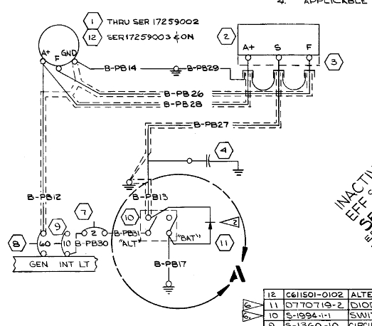

When this decidedly automotive system was adapter to the airplane
at Cessna, the first systems went in like this:
[img]cid:.0[/img]
Here, the "S" terminal became "switch" and the field
relay got power directly from the bus as opposed to the
AUX terminal. It no longer sensed rotation of the
alternator. The "I" terminal could have been used
to drive a light . . . but it was even less meaningful
than when used in cars . . . it would be dark any time
the field switch was ON whether or not the alternator
was actually producing power.
