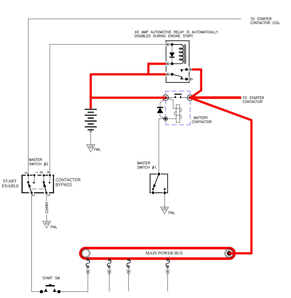

PostPosted: Fri Jul 06, 2018 4:16 pm    Post subject: Re: Z-13/8 Failure Question Reply with quote
If you want to back up the battery contactor, the attached drawing is one way.
The small relay is disabled during engine cranking to prevent overloading its contacts.
I am not necessarily recommending this circuit, just offering it as an option.

Definitely not looking to add another contactor. I suppose you could set up the efis to monitor engine bus, but why not just hook the LR-3 to it instead? Then instead of just telling us the alternator is working it also tells us if it's charging the battery. Reduced part counts is always nice too...
That would render any low voltage warnings from SDS unnecessary.

nuckolls.bob(at)aeroelect wrote:
At 05:01 PM 7/6/2018, you wrote:
--> AeroElectric-List message posted by: "BMC_Dave" <bmcdave85>
Been pouring through the forums recently, lots of great info and I've been able to answer most of my own questions so far. I'm curious about a particular failure since I'm designing for a SDS EI/EFI plane, perhaps I don't fully understand how the LR-3 module works.
The LR3C alternator controller is an adjustable
linear regulator combined with crowbar over voltage
protection and low voltage warning.
In Z-13/8 if the battery contactor fails, exceedingly rare and probably with some warning prior to being critical, is there any notification that such a failure has occurred? Any indication the battery has been disconnected from the main ALT?
No. You probably won't be aware of a battery contactor
failure until you're on the ground and just happen
to shut alternator(s) down first . . . or attempt
a preflight for your next sortie.
I'll be switching the ECU and injectors off the main battery bus. So if what I'm thinking is true I won't get any indication I'm running the engine only off battery power until it stops. An unappealing prospect...
Add lv warning to the battery bus . . .
https://goo.gl/sNBCja
You would hook such a gizmo to the downstream
side of one of the engine accessory switches
such that the lv warn gets powered down with
the engine.
Also, looking at the reference figures online are these Z-figures the most recent? I ask because it seems the wiring for the main ALT in Z-13 doesn't include the LR-3 module, I have to look at Z-12 for that. Not hard to modify for the combined module, just wondering if there is a Z-13 version out there that includes this. Thanks!
The Z figures are ARCHITECTURE drawings, not wire books
nor are they intended to drive decisions for selection of specific
components. One might use any combination of ov/lv/regulator
in lieu of the LR3 and vise-versa.
Battery contactor failure in flight is exceedingly rare.
They nearly always annunciate impending failure during
an engine start. But be attentive to the FIRST signs
of fussiness . . . I had a renter on 1K1 that would
go rap on his Cherokee battery contactor with the handle
of a screwdriver with the master switch ON . . . seems
that this shade tree mechanic's move gave him better
starts. We moved off the airport before the contactor
went TU so I don't know how long the work-around serviced
his intentions to go flying.
Contactors I've replaced had been in service years . . .
sometimes decades. Teardown inspections showed that
the devices were pretty beat up. Whisky barrel contactors
are best mounted cap down . . . with a small vent/drain
hole added to the hi-point of the cap.
Works good . . . lasts a long time . . .
