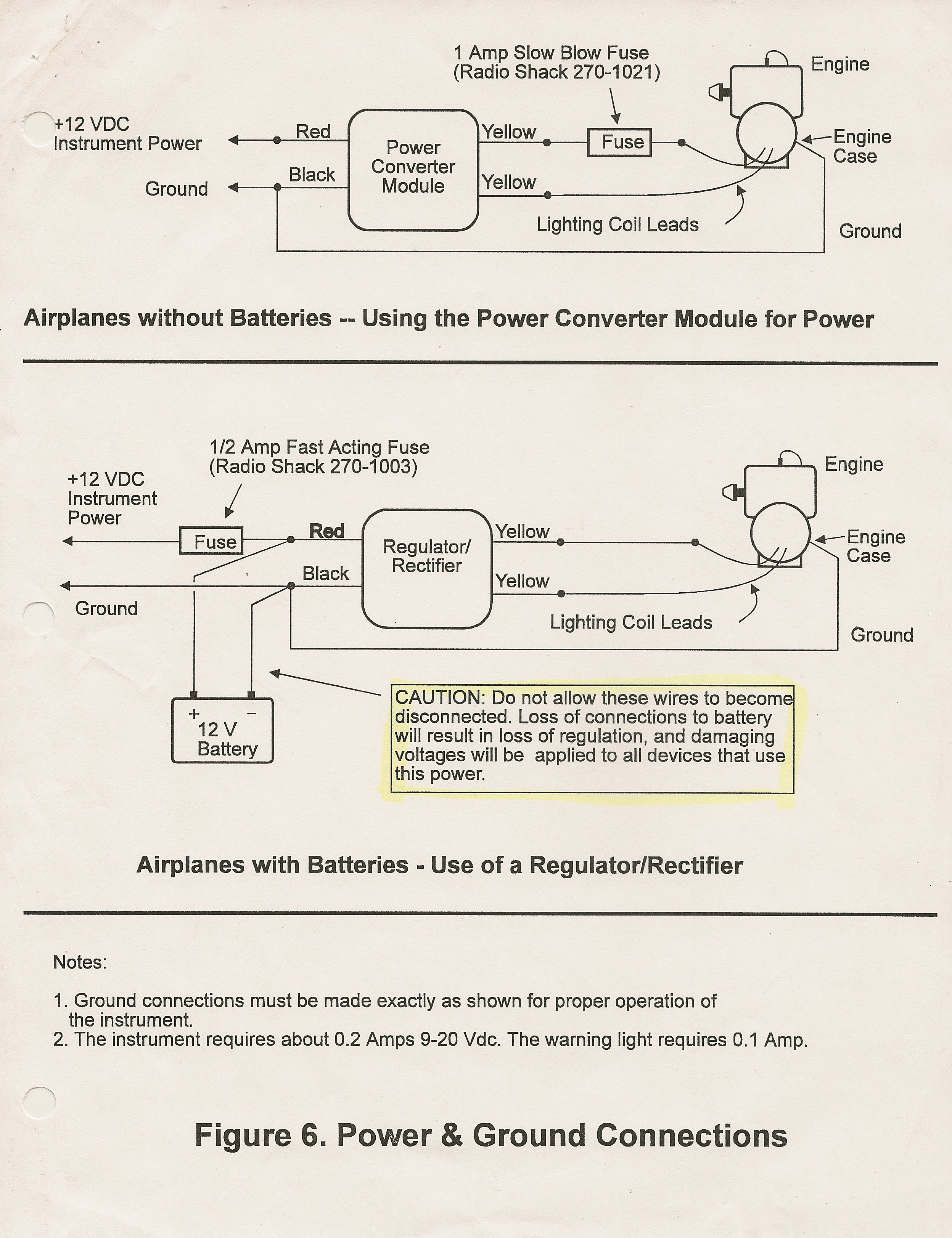

Is this what you are looking for?Larry

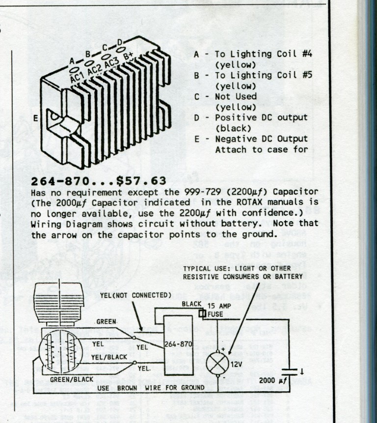

Here is another page of the use.

Sorry; no. I consulted this doc:
http://m.cps-parts.com/cps/pdf/Part49.pdf
The 1st model they sent matched the non-heatsink version in both appearance and performance. The 2nd looks like the heatsink version, but wire colors are different. I was just hoping someone had used the Misubishi brand regulator & could verify wire colors.

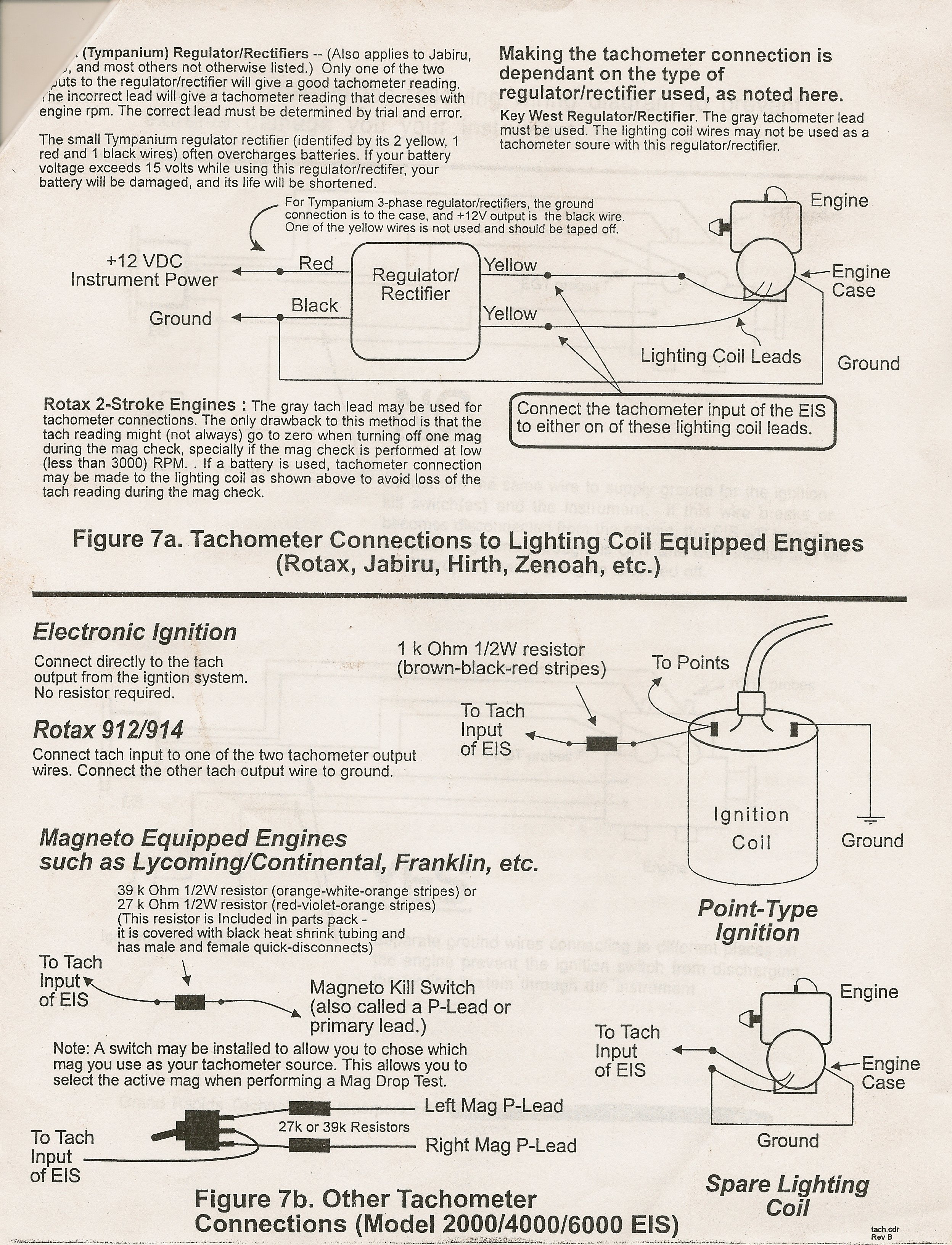

This is for the older type 503 ignition. Not sure if this is what you need, but it's free, so...

Thanks Richard, but that appears to be the  same hookup as the one I linked earlier. I'm fairly confident in my guessing on hookup, reinforced by my initial measurements. Since no one seems to have used this brand, I'll just go with what my initial checks indicate are the correct terminations.
Charlie
