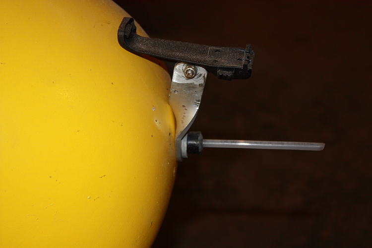

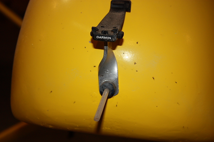

I have a pitot tube from ACSpruce that is made of plastic and the tube holder is threaded. It is  made so that you can remove the pitot tube to keep a knucklehead from brushing against it breaking it. I took a piece of alum. flat stock and bent it to accommodate the holder for the virb. That point is the least amount of vibration in the plane. Not sure if it works for you or not, but it does for me.Larry

I’ll work on that. Thanks, Larry.
