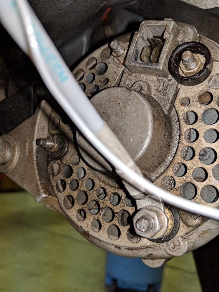

I need help. I bought a used engine and it came with an alternator that has no labels that I can find. How do I hook it up?
Engine: Lycoming IO-360-A1A
Alternator: looks like this:
[img]cid:ii_ji12srt00_163cdd044737ee71[/img]

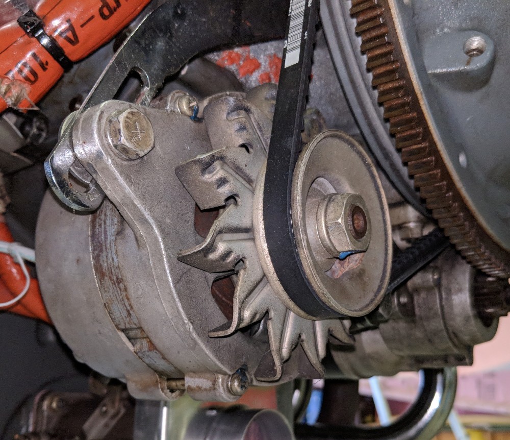

Back of the alternator has three Faston tabs and what looks like a screw terminal next to them:
[img]cid:ii_ji12tk0g2_163cdd0d21dfc1df[/img]
I bought a B&C LR3C-14 voltage regulator and ran the field wire to one of the Faston tabs. I have confirmed that I do have voltage at the alternator end of the wire. However, with the engine off, my EFIS does not show any current draw when I turn on the primary alternator. When I run the engine, the primary alternator does not produce any current.
I also have a B&C standby alternator with its B&C voltage regulator. That one works just fine. With the engine off, I see it's field draw about 0.5 amps. With the engine running, the standby alternator pumps out plenty of amps which the EFIS nicely displays.
How should I connect the primary alternator? And what is it?

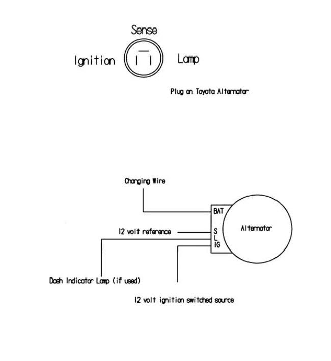

That *looks* like one of the early internally regulated alternators. If I'm right, it needs to see 12V on the 'I' (or 'IG', for Ignition) terminal to 'turn on'. I'm attaching a drawing (let me know if it doesn't come through) of a similar alternator. the 3 pin shell is shaped differently, but I believe that the pinout is the same. On the rather primitive electrical system I had, the IG pin was simply jumped to the B lead terminal. Not advising you to operate it that way, but you can test for operation by doing that. If you jump from B lead to IG, start the engine, and get ~14V out on the B lead, then you have an internally regulated alternator.
Note that I might be wrong; be sure none of your avionics are connected when you do this test....
Charlie

That is a Automotive Alternator.  Not an Automotive Alternator that is used on a certified aircraft.
The give-away is two (2) things:
1 - The alternator has the plug-in socket which indicates it has a BUILT IN voltage regulator (ACU).
2 - The fan blades are facing the wrong direction.
Side Note:  The Tension Adjustment Bolt is not Safety-Wired.
Since you have easy access to the alternator PULL it and take it to an Automotive Part Shop and have them test it.
My bet is it will work, but NOT with a second ACU (plane's), since it has one built in.
I bought a B&C LR3C-14 voltage regulator and ran the field wire to one of the Faston tabs. I have confirmed that I do have voltage at the alternator end of the wire. However, with the engine off, my EFIS does not show any current draw when I turn on the primary alternator. When I run the engine, the primary alternator does not produce any current.I also have a B&C standby alternator with its B&C voltage regulator. That one works just fine. With the engine off, I see it's field draw about 0.5 amps. With the engine running, the standby alternator pumps out plenty of amps which the EFIS nicely displays.
Unless you have specific information that
speaks to a modification of this alternator,
it's prudent to assume that it's a stock,
internally regulated alternator. It would
NOT benefit from the addition of an LR3C
until it is modified to bypass the internal
regulator and bring the field leads out
for interface with the LR3C.
This is essentially what B&C does with
stock ND alternators to make them more
'aircraft friendly'.
You may choose to run the stock alternator . . .
indeed a large number of OBAM aircraft are
flying stock automotive machines. The
only risk, albeit a small one, is that
these alternators have an internal failure
mode that produces an uncontrollable
voltage runaway condition.
