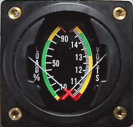

Back in the not so dark ages, we offered a voltmeter/
loadmeter combo featuring a dual pointer instrument
that was custom made for us by Westach. Their product
was mostly okay . . . but about 10% of the goods were
unusable right out of the box. Tried to get warranty
replacements but they said, "sorry, you've had that
instrument for more than 90 days."
[img]cid:.0[/img]

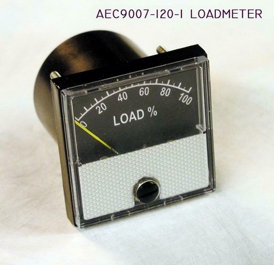

Had to discontinue that offering. Another attempt
to address miniature 'steam gage' loadmeters was
launched with this product.
[img]cid:.1[/img]

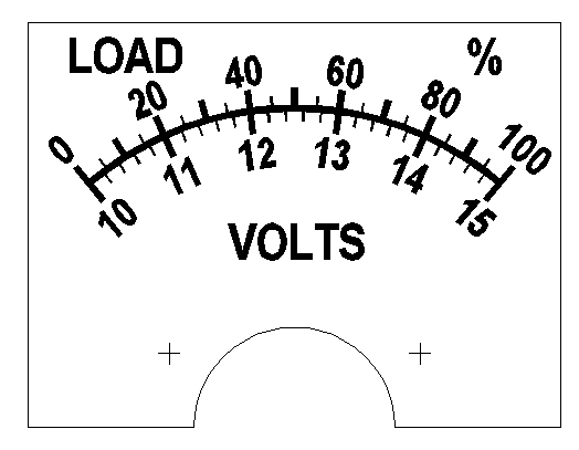

. . . and we fiddled with the notion of creating
a single pointer, dual scale instrument in the same
package.
[img]cid:.2[/img]
It didn't seem to be a very viable project since
these functions were being covered by most of the
digital do-everything instruments coming into the
market.
This is an example of what Jerry is talking about
for the expanded scale voltmeter.
 Filesize:  94.14 KB
 Viewed:  11565 Time(s)
 Filesize:  90.56 KB
 Filesize:  67.05 KB
