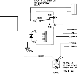

Is the diode installed correctly across the alternator disconnect relay coil?

So, it's *not* wired exactly like Z-16? Wink
Let's do some circuit analysis.
Follow the wiring diagram: bus>fuselink>CB>switch contacts<[OV module, relay coil, and diode (missing in your plane), all three in parallel to ground].
So if you turn off the alternator section of the switch, the only thing connected to the OV module is the relay coil. (Remember, you're missing the diode.) So, two issues. First, ask yourself where the excess voltage could be coming from, that the OV module is seeing. Next, ask yourself how the OV module can trip the CB, since the switch contacts connecting the CB to the OV module are open, breaking the current path from the bus, through the CB to OV module.
I suspect you have multiple wiring issues, one of which is the missing diode.
ground].
to OV module.
diode.

Now all we have to do is figure out how the O.V. module tripped the circuit breaker with the switch open. The only thing that I can think of is that it happened during the time that an arc was jumping across the opening contacts.
Is that long enough to trip a breaker? Or maybe it is not wired like Z-16. Instead maybe the O.V. module is connected to the other side of the switch. The O.V. module will still function OK if it is.

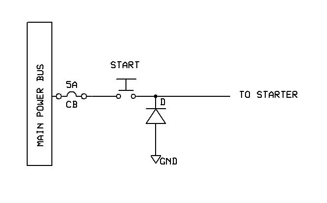

PostPosted: Sun May 27, 2018 1:48 pm    Post subject: Is the OVP 5 A CB supposed to trip when I switch off the al Reply with quote
Joe & Bob:
I was not able to link to the Z-16 schematic but if it is like what you just posted Bob, the diode trick has been around for many years.
I'm sure there are different names for the way it is being used, the name I know it by is: ANTI-BOUNCE DIODE.
Gaggle - If you look at the diode it is put in the REVERSE Polarity Direction of the applied voltage.
Without the diode - When the power to the relay is removed, the collapsing field of the relay produced an induced voltage in the opposite direction as the energizing voltage. This voltage caused the relay contacts to BOUNCE and not open the contacts as quickly or as definitively.  This of course caused excessive arcing of the contacts, shortening their life and even welding the contacts closed and/or carbonizing the contacts.
So, if the OV circuit is sensitive enough and fast enough it could react to the induced spike.
Oh . . . THAT diode. . . missed that part of the
thread . . .
[img]cid:7.1.0.9.0.20180527160500.05edfe98(at)aeroelectric.com.0[/img]
Anyway, glad it is working for you Will.
   I've seen this before . . . field collapse spikes
   on a beefy relay have been known to irritate the
   crowbar ovm. Had a Europa builder in Wichita having
   a similar problem with the avionics master relay
   in his EXP Bus system. Tacked a diode across the
   relay coil and order was restored in the universe.
thread . . .
thread . . .
<243745d4.jpg>

An arc suppression diode needs to be connected in parallel with the inductor with the banded end of the diode connected to positive. The ideal physical location of the diode is as close to the coil as practical. However, the diode could be located at the switch that turns the coil on and off. Even so, the diode still needs to be connected in parallel with the coil. A diode will limit induced voltage to about 1 volt, which is the forward voltage drop of the diode. The main purpose of an arc suppression diode is to protect the controlling switch contacts from arcing. Below is a picture of a diode located at the switch. Notice that even though the diode is located remote from the contactor coil, it is still connected in parallel with the coil. The banded end of the diode connects to the positive side of the coil, and the other end of the diode is connected to the negative side of the coil (through ground). Connecting a diode across switch contacts does little good.
 Filesize:  20.3 KB
 Viewed:  15982 Time(s)

It will not make a difference if the relay interrupts AC from the dynamo or DC from the rectifier/regulator.
Looking at Z-17, there is no diode across the relay coil. When the alternator switch is opened, induced negative voltage will be applied to the red lead of the O.V. module. I think a diode should be connected across the relay coil.

At 02:37 PM 5/27/2018, you wrote:
--> AeroElectric-List message posted by: "user9253" <fransew(at)gmail.com (fransew(at)gmail.com)>
thread . . .
<243745d4.jpg>

On Sun, May 27, 2018 at 5:11 PM, Robert L. Nuckolls, III <nuckolls.bob(at)aeroelectric.com (nuckolls.bob(at)aeroelectric.com)> wrote:
thread . . .
<243745d4.jpg>
Joe Gores
http://forums.matronics.com/viewtopic.php?p=480463#480463
http://forums.matronics.com//files/diode_arc_suppression_166.jpg
