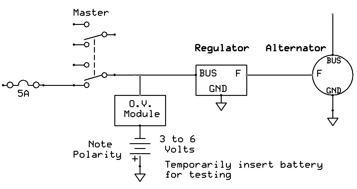

How about this circuit. Picture attached.

Joe, I should have mentioned that I am still in "kindergarten" regarding electronics. I am just not following your diagram. It looks to me like it shows disconnecting the ground wire from the ov module and connecting it to the negative terminal of a 3-6 volt battery, and then connecting the positive terminal to ground? Somehow I think I cannot be reading it correctly, and even if I am, I am baffled as to how this would test the 16 volt set point for the ov module. Ken

You are reading the diagram correctly. When batteries are connected in series, they are connected negative to positive to negative to positive. When the over-voltage module is disconnected from ground, the loose wire will be positive. If you insert 3 flashlight batteries in series as shown, the voltages add up. 12 volts for the aircraft battery plus 4.5 volts for the flashlight batteries equals 16.5
If you want to trip a 5 amp circuit breaker, "D" cells should do it.
Joe Gores

Thanks Joe. I understand now (mostly). I tried the two 9 volt batteries and that didn't work. I completely forgot about "current" needed to trip the breaker. Also, I guess I didn't really understand how the ov module works. I thought it was just a normally open micro switch that "magically" closes at 16 volts. I would have thought the ground wire of the ov module would be "dead" at less than 16 volts. But now I realize it must be more than that. It must be that current constantly flows through the ov module, but at 16 volts something else happens. I must have read an explanation in the "Connection" but obviously it didn't stick.
Also, I will be tripping a 7.5 amp breaker. The buss will be powered by a 17 amp power supply (max setting is 13.9v). Do you think the three D cells will trip the larger breaker?
Ken

I rigged up three D cells as Joe suggested and the OV protection system checked out okay. The breaker tripped as expected. Thanks everybody.

The over-voltage module normally conducts very little current. I do not know how much but perhaps microamps or a few milliamps. Unless there is a good reason for using a 7.5 amp breaker, I would replace it with a 5 amp so that it will trip sooner. I tested a homemade over-voltage circuit one time and the breaker smoked instead of tripping. Many power supplies will automatically shut down when short circuited.
I do not know the maximum current of a D cell. That 7.5 amp breaker will require more than 7.5 amps for a certain amount of time before it will trip. That is asking a lot out of a D cell.
If you only want to test the O.V. module and not the breaker, disconnect at least one of the O.V. module wires from the aircraft. Connect the O.V. module and your two 9 volt batteries and a 24 volt test light all in series. Make sure battery polarity is correct, positive to red.
Even if the O.V. module works at 18 volts, you will not know if it works at 16 volts.
