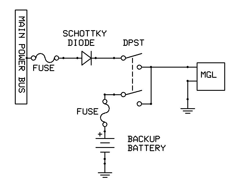

Here is circuit. A disadvantage is 1/2 volt drop across the Schottky diode.
But if the aircraft electrical system voltage is 14.2 or higher, it should be OK.
Diode part number: 747-DSA300i45NA
If the voltage drop across the diode is not desired, normally closed relay
contacts could be connected in parallel with the diode. Energize the relay
with the start push button.

That one appears to be buck only. Should still work fine if you only expect brownout protection. It can't do full charge voltage, but can likely do around 13-13.5v when fed 14.5 by the alternator.
But if you're doing that, it would be simpler and cheaper to just use a fat schottsky diode. Again, ebay for the best price.
Charlie
On May 14, 2018, at 8:53 PM, Art Zemon <art(at)zemon.name (art(at)zemon.name)> wrote:
Charlie,
That sounds like exactly what I need: brownout protection for one to two seconds. Is this the sort of regulator that I need? https://www.ebay.com/itm/DROK-High-Efficiency-Regulator-DC-4-5-30V-to-0-8-28V-12A-Buck-Converter-Const/152990560495
-- Art Z.
On Mon, May 14, 2018 at 7:59 PM, Charlie England <ceengland7(at)gmail.com (ceengland7(at)gmail.com)> wrote:
Ebay for a 'boot/buck switching regulator' sized for your needs (likely way less than$30), and an aux battery sized the same way. Create a 'mini' bus for the items you want to isolate.
If all you want is brownout protection, a little 2 or 3 AH battery shoul be more than enough.
There are other commercial products available that do the same thing, but obviously you will pay more.
Charlie

Don't you want a boost converter instead of a buck converter?
Ken

See my 1st answer. Smile
Boost only woul not be a good idea; that implies a set point higher than alternator voltage.
Charlie

I would go for this Voltage Slump Eliminator first -  a passive device.
Switchers must be designed to generate little radiated and conducted
interference - see the discussions on usb-charging.
Jan de Jong
