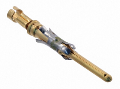

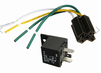

There was just a long thread on this email site that discussed Insulated Crimp Connectors. The insulated part of the lug Supports the insulated part of the wire. It gives it a secure holding point that DOES NOT cut into wire.
B-crimp termination of wires on airplanes has
appeared in the bills-of-materials on tens
of thousands of type certificated aircraft
for decades. I was at Cessna when the AMP
Mate-n-lock products were incorporated into
the wire harnesses. I too was skeptical of
these 'new kids' on the block that seemed
to dangerously ignore techniques and
lessons-learned in the PIDG technology which
was then already decades old.
[img]cid:.0[/img]
The open-barrel, b-crimp technology now has
a field-service record demonstrated in hundreds
of millions of vehicular and stationary applications
that makes them imminently suited to use on
aircraft. The insulation grip does not have to 'cut
into the wire' . . . as I described in the b-crimp
tool comic book (and illustrated in this image
from Tyco-AMP), the insulation grip should get a
'bear-hug' on the insulation without damage to it.
These terminals were designed to be part of a
harness connector wherein two or more wires were
brought into a plastic housing as a female
connector that mated with a switch, relay or
other device.
There are hundreds of millions
of examples of this technology in service all
over the planet . . . including virtually all
cars and trucks on the road today. B-crimp
terminations probably outnumber PIDG style
devices by several orders of magnitude.
[img]cid:.1[/img]
My only concerns for the style illustrated
were for the lack of finish and perhaps an
unknown pedigree for the material's mechanical
properties that go to maintenance of gas-tight
electrical connection.
But if these are found in catalogs from
manufacturers like Tyco-AMP, Molex, etc . . .
it is likely that those concerns are moot.
If one wished to use these devices as
mates to individual fast-on tabs, one could
consider adding heat-shrink over the whole
terminal . . . which offers more cover than
the PIDG devices.

PostPosted: Fri May 11, 2018 5:57 am    Post subject: Faston / Aveo Tab Terminals Reply with quote
Bob:
You are mixing Apples and Apple Sauce and coming up with Lumpy Apple Sauce.
Those are PINS not Lugs.
The Pins are supported by the connector.
The Lugs are hanging out into the air. No support!
And that is why PIDG type Lugs are preferred!
Barry
