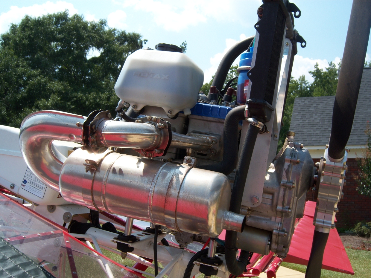

PostPosted: Tue May 08, 2018 4:39 am    Post subject: Re: High Thrust Line Question Reply with quote
victorbravo(at)sbcglobal. wrote:
S- N- I- P
With the 3.47 gearbox I have, a three blade propeller with 62-64 inch diameter is not enough... the engine will overspeed before I get the full amount of thrust.
S- N- I- P
Bill Berle
S- N- I- P
MY FS II is equipped with R503 DCDI, a C Box 3.47 - 1, mounted in the "Up" position and swinging a 68", 3 blade Powerfin 'F' model prop.
In a couple of hundred hours, have encountered none of the problems you identified as potential ones.

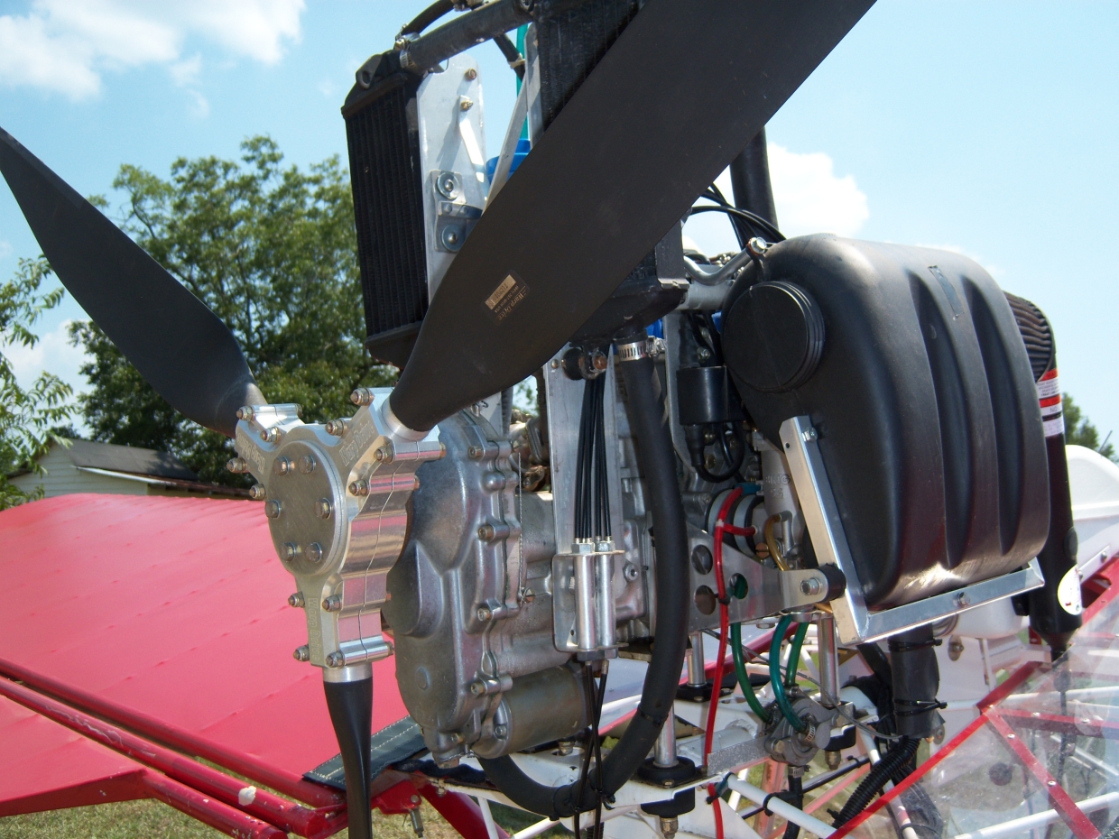

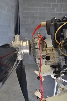

PostPosted: Tue May 08, 2018 5:09 am    Post subject: High Thrust Line Question Reply with quote
Don't bother wasting your time calling Darryl. He'll tell you that the gearbox won't work, blah, blah, blah. Horse exhaust. He told me that the 4 to 1 gearbox I run with a 582 was all wrong. Funny thing though, when I had a 582 in the shop with a 2.57 gearbox I started swapping props between the two. I had to put about 20 minutes (yeah, 1/3 of a degree) more pitch on the 4 to 1 engine. Otherwise, performance was the same. For what it's worth, the R3350's of the B29 turned the prop at a bit over 900 rpm.Suggest you leave the gearbox in the up position and put the short side up on the front engine mount and put the rear mounts long side up.
Don't know if it will transfer from the Mk III but the lower prop rpm allows me to run a rudder trim tab that's about 1/3 the size of the factory recommended tab and the total deflection angle is only about 5 degrees. I need a tiny amount of right rudder on takeoff and a bit of left rudder in cruise.
As for running a four or five blade prop, I have run a three blade Warp and a four blade Power Fin on my HKS. No difference when set right. I even stripped the Power Fin back to two blades. It vibrated a bit more and made virtually no difference so I put the other two blades back in.
If you think your thrust line is high, look at the pics. Travis told me the factory set this engine up for the fourth owner of the PFH (plane from hell) who just had to have an "E" gearbox.
Your HKS will power your Firestar just fine, your prop will work just fine.

PostPosted: Tue May 08, 2018 5:19 am    Post subject: High Thrust Line Question Reply with quote
PS, the other benefit of lower prop rpm is that your airplane will be a whole lot more quiet. My neighbors told me they could hear the 2.57 gearbox engine all the way around the pattern, but the 4.00 gearbox was below hearing level when the plane was on downwind.
Rick
On Tue, May 8, 2018 at 8:08 AM, Richard Girard <aslsa.rng(at)gmail.com (aslsa.rng(at)gmail.com)> wrote:
I set my HKS so that the prop tops out at 6000 rpm on climb out.
Rick

Richard Pike
Posts: 1671
PostPosted: Tue May 08, 2018 3:38 pm    Post subject: Re: High Thrust Line Question Reply with quote
Bill; notice the extent to which Rick raised his engine. (Great pictures) Maybe you can leave the gearbox down and raise the engine up?
Rick
up?
> Richard Pike
which
> Rick
engine
> up?
>> Richard Pike
