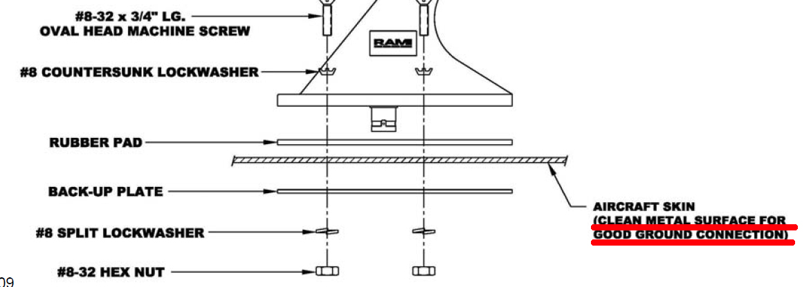

From RAMI
CLEAN METAL SURFACE FOR GOOD GROUND CONNECTION
[img]cid:ii_jgzca7dg0_16345cefb2ed3089[/img]

Also, the Manufacture's last capitalized line reads: CLEAN METAL SURFACE FOR GOOD GROUND CONNECTION
and is repeated again with RED underlining.
It does NOT say the entire area under the antenna.
Which is what the 'bonding circles' around
the screw holes are about along with maximizing
compression of the various layers at each
joint. These make up gas-tight interfaces that
will repel oxygen/moisture. Again, another good
place for a bit of DC-4 around the hole before
bolting the antenna down.
