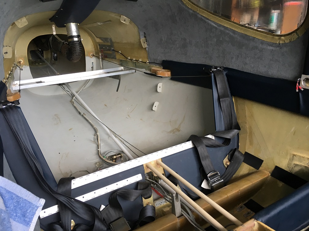

I might not be the best one to answer your question since I am still at the 90% level but I put mine on a shelf behind the baggage compartment. Leveled from front to back and side to side as far from any potential interference as possible. Just bonded two angled alum pieces on each side and then a shelf between them.
See photo:
Hope this helps.

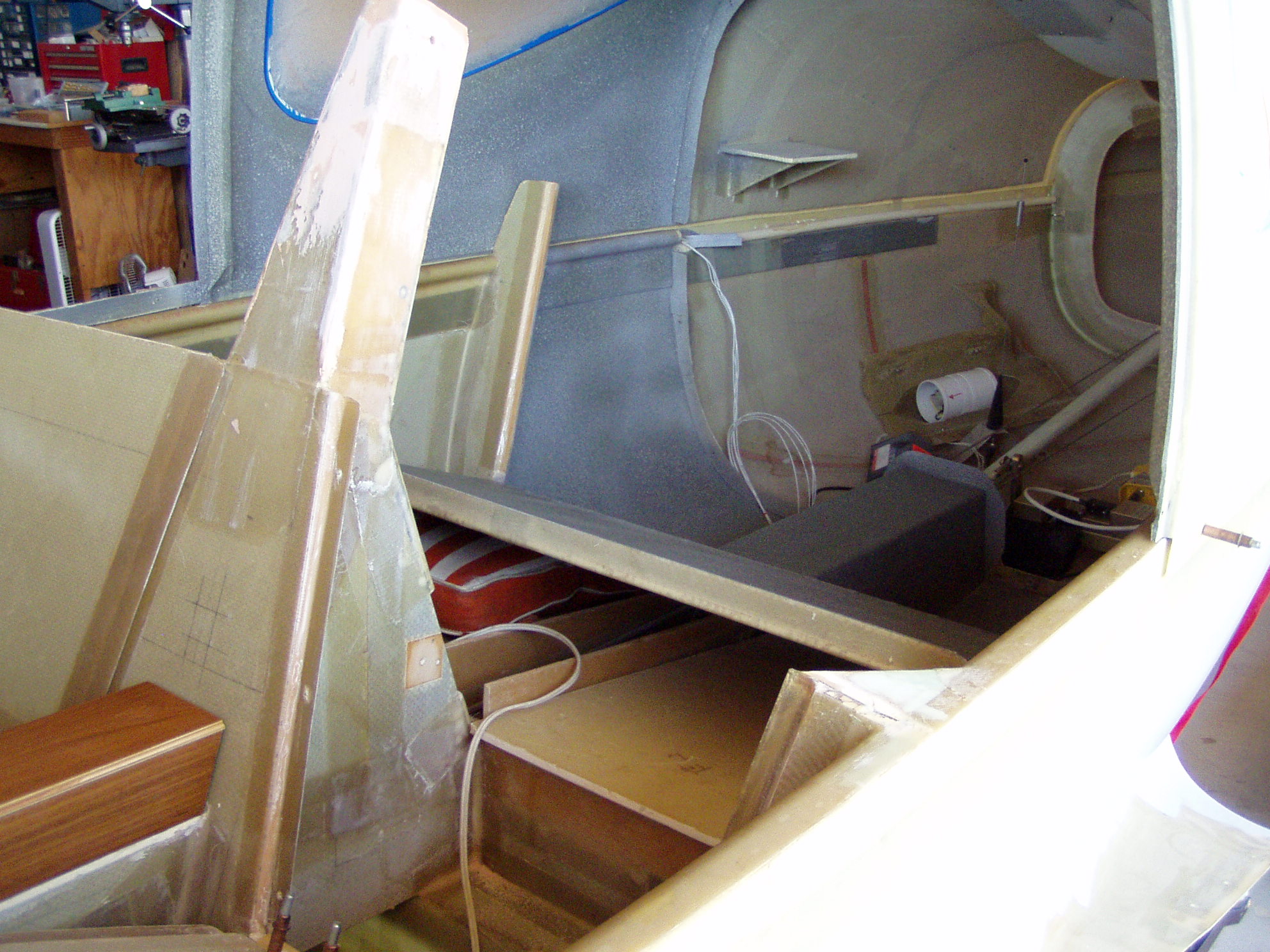

I put the magnetometer behind the bulkhead on a small fiberglass shelf. AHRS was in the panel unit. This has worked well.
