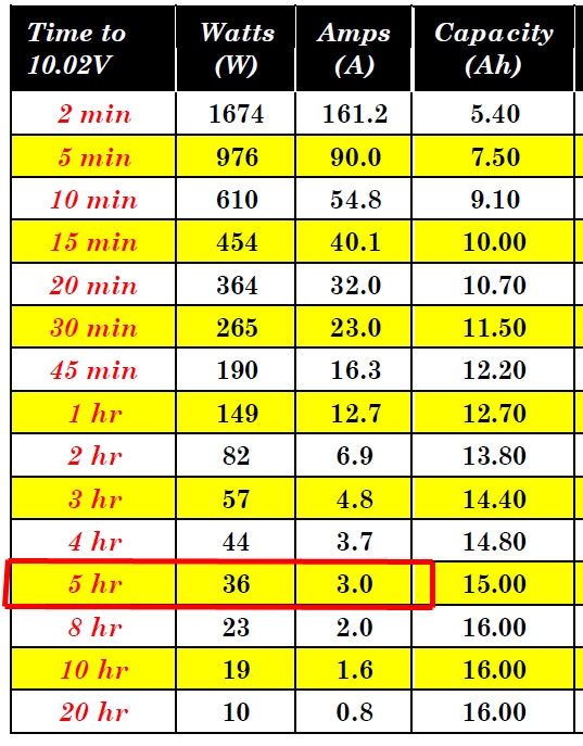

The e-bus was conceived one evening about 1988 in
conversation with a LongEz builder in California.
This fellow did a lot of long distance travel over
mountains. I don't recall if his airplane had a
starter . . . don't think it did because I do
recall that he was fitted with a pretty light
battery in the nose.
The design goal being pondered was how to create
a battery-only endurance greater than his fuel
endurance . . . which was rather long.
At that time, his electrical endurance loads were
as I recall, about 3 amps. A battery contactor draws
about 0.8A after warm up . . . enough snort to run
a couple of useful electro-whizzies yet this energy
was tossed off as heat. His SD-8 would support normal
flight loads including contactor.
[img]cid:.0[/img]
His endurance loads must have been a bit less than
3A because I recall we decided that a new 18a.h.
battery would carry his anticipated loads for 6
hours, hence his 4-hour design goal would be
satisfied to 75% of new capacity whereupon
the battery gets replaced.
So the e-bus was conceived as a method for setting
up a fixed, predictable battery-only endurance load
with a simple re-positioning of two switches.

PostPosted: Sat Apr 21, 2018 9:24 am    Post subject: Z-12 contactor failure Reply with quote
Hmmmm . . . my recollection of details may be
a bit fuzzy after 30 years, 4 hours is 66%
of new . . . anyhow, this illustrates the
thought processes for design decisions.
